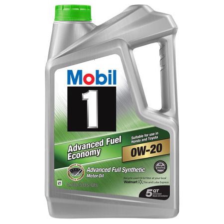

    i have a prius with 115,000 miles and still running strong.
    I bought the car with 98k miles.
    I've been reading that people reccomend Mobil 0w-02 synthetic oil.
    Or should i use a different type of oil because of the miles or can i keep using synthetic oil no matter the mileage.
    i uploaded a picture of the oil (is this the correct oil everyone is talking about)
    i asked the dealership if i could bring in my own oil since they use penzoil and they said yes.
    another question i have is -should i get my oil filter changed.
    Thank you for the responses.

    I use it in everything I own. I feel it gives better protection? Most manufacturers use 0-20 these days. I live in a hot climate and have had excellent results. Some folks that live in your area believe it has too low a viscosity for your very hot climate. Maybe old school thinking, I'm not sure. It's in my garden tractor and both my Prius autos. Hal

    1. Toyota recommends 5W-30 from the 2nd Gen (2003-2009) Prius model. The 0w-20 was recommended for the 2010-present Prius models. I have used other heavier weights with little to no effect on gas mileage. From BITOG and other sites, the best 0w-20 is Toyota branded 0w-20. Also, 0w-20 must be synthetic due to the fact of its 0 weight. The key is to change the oil regularly. I'm sure that the 0w-20 weight will work perfectly fine but I prefer a heavier weight of oil if not just std 5W-30. I live in SoCal, so we never see below freezing temps anyways. The increase in mpg is minimal by using 0w-20 and I believe it became a popular toyota oil due to its synthetic nature and allowing the manufacturer to extend oil change intervals to 10k miles, thus enabling marketing claims and decreased maintenance costs.
    2. Yes, changing the oil filter is very important since it holds a decent amount of oil and is 1/2 of a complete oil change job. It'd be foolish not to change the filter since its only a few bucks for the filter itself. There are also quite a few over sized filter options. I currently have an oil filter that increases my total engine oil capacity by nearly .5 quarts.

    You live in a hot climate. Your car has a high mileage. Stick with 5w30.
    IF your car was low on miles then maybe give the 0w20 a go, but suddenly changing to a thinner grade of oil on any high mileage car is asking for trouble.

    Personally I'd never change from 5w30 to 0w20 in any car with over 60k miles on it as it's asking for trouble. If you have always used 5w30 at you're at 150k, then continue to use 5w30 (synthetic or otherwise).
    Above refers to a 2008 gen2. The gen3 should always have used 0w20 from day one.

    Noooo! Don't use that one. Way too thin for your car. oW-02 is for small watches.

    OP of course meant to say 0W-20, but for Gen2 I stick with Mobil-1 5w-30 and also 0W-30 Advanced Fuel economy if you want to is fine. Of course, there are other quality synthetics brands out there. For me it's Mobil-1 from Walmart.

    That's strange as reported before by myself and others 0w-20 is fine for the gen2 Prius, and is the oil of first choice according to my 2008 handbook, and filler cap on the car. It is also the oil of choice in all new Toyota hybrids using the same 1.5 ltr engine.
    The oil is also listed as suitable on the Toyota oil specification sheet below.
