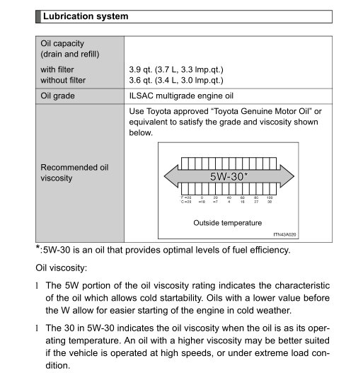

    Ok I simply don't believe that document is correct. It conflicts with too much other information, including the owners manual which merely specifies the grade (5w30) and the minimum specification (ILSAC in the US, API SJ here in Australia) and makes absolutely no mention of synthetic vs non synthetic.
    In fact the distinction between synthetic vs non synthetic is completely irrelevant. The oil either meets the required specifications or it doesn't, how that oil was refined or produced is entirely irrelevant. You might as well quote an official Toyota document that says that the oil must only come in a green bottle. :) If you do then I'll dismiss that as well.
    If you look closely at that document you will see that the author totally conflates 0w20 with synthetic and 5w30 with non synthetic. The latter is completely incorrect, most 5w30's these days are either full or part synthetic, which in my opinion renders the "S/NS" part of that document as completely meaningless.
    BTW. Here is the relevant part of the US manual (first attachment). The recommendation is 5w30 and ILSAC. No mention at all regarding synthetic vs non synthetic.

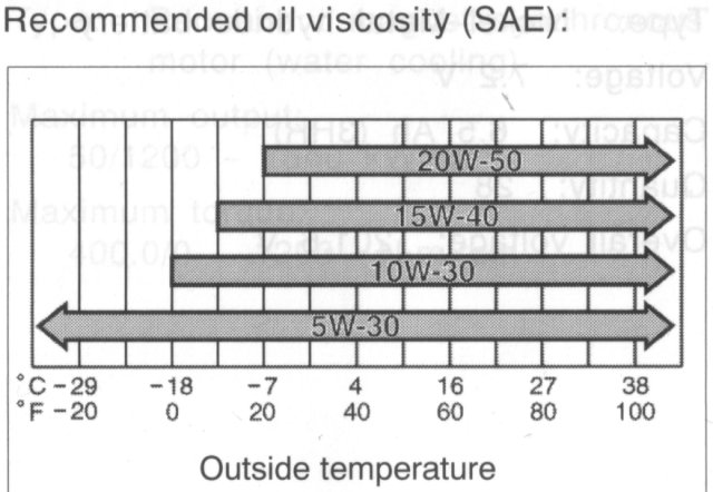

    The Australian manual is much the same except they allow for a wider choice of viscosity, depending on the expected operating temperatures, and they specify API SJ instead of ILSAC (same engine protection specs but not so stringent fuel efficiency specs, allowing for more choice in grades). The second attachment shows the recommenced viscosity (grades) scanned from my 2005 manual.

    Uart what lower range of temperatures do you get in the Australian winter? I know this will vary depending on the location within the country.

    Hi John. I'm in the mid coast region of NSW, which is a fairly temperate climate. It rarely drops below about 5C (40F) here. You know the "snowflake" ice warning icon, it comes on at about 3C. Well we had the Prius for about 3 years before first seeing it! I didn't even know what it was and had to go home and look it up on priuschat. :)
    Australia also has a tropical climate in the north and some alpine regions in the south, but probably the largest population centres are a temperate climate.

    The OP is using heavier oil than most other people in other parts of the world where 5W-30 would be normal. He is using 10W-40 as ambient temps are in the 50ÂșC range in the hottest part of the year, which is reasonable.
