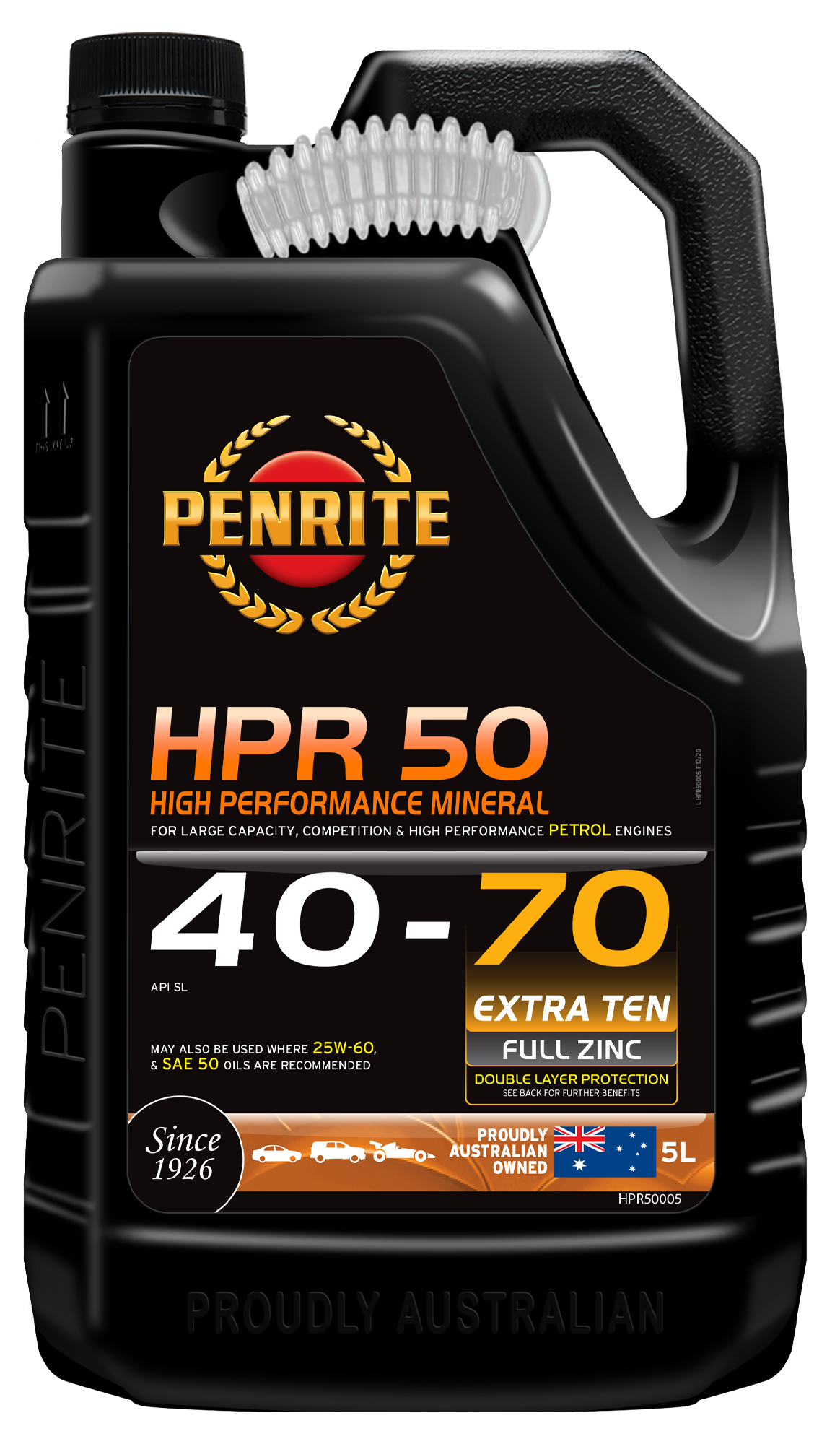

    The article incorrectly stated that they were working on SAE 0W-16 oils since the 1990s. No such viscosity grade was defined in SAE J300 until 2015. Back in those days, they unofficially called thinner oils SAE 15, SAE 10, and SAE 5, even though no such viscosity grades were defined. No one even talked about SAE 16 for sure, let alone it be defined. Circa 2015, when SAE 8, 12, and 16 were finally being defined, they surprisingly used 8, 12, and 16 instead of 5, 10, and 15 to eliminate confusion with SAE 5W, 10W, and 15W. The article should have said that they were working with thinner oils. The viscosity of these oils could be anything as far as we know.
    It's like Penrite 40-70, even though there is no such thing as SAE 70 or a multigrade that starts with SAE 40. See the fine print that says that it can be used instead of 25W-60, the latter of which is the thickest multigrade in SAE J300. Also note that "SAE" is eliminated in the viscosity label because that would cause legal action against Penrite for selling a SAE J300 viscosity grade that doesn't exist.
