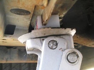

    For jacking, I use this custom pinch weld adapter.
    10,000 miles is too long.
    3,000 to 5,000 max.
    RollingPanda and VelvetFoot like this.

    2,605
    Taylors, SC
    Better than nylon. Ultra durable UHMW Spectra. Hard to cut with the pinch weld "knife edge" even with the car's weight landing on it.

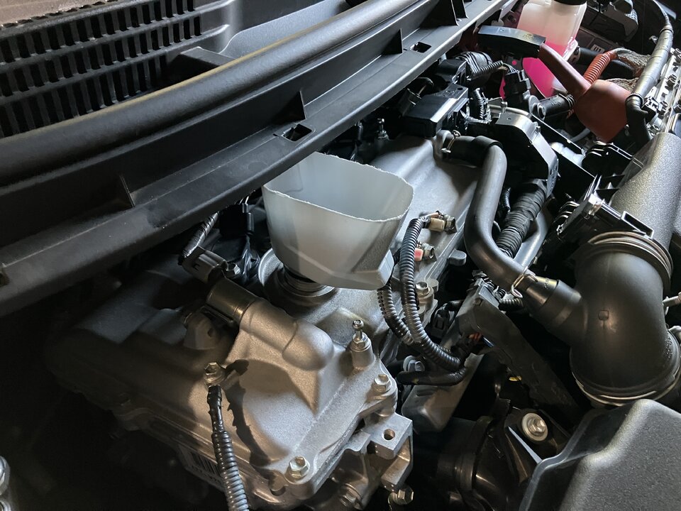

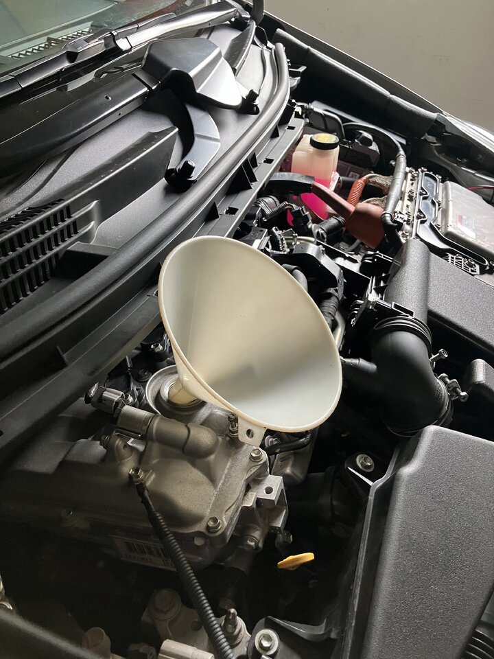

    Tried @Ragingfit style yesterday:
    An offset funnel is almost necessity with gen 3. How I have been doing it:
    #10 Mendel Leisk, Oct 7, 2025
