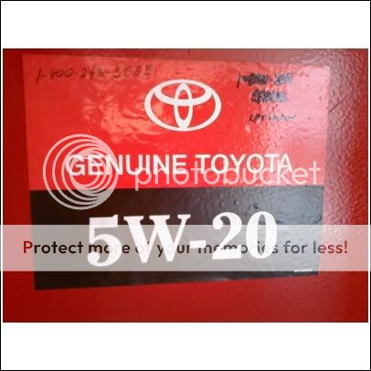

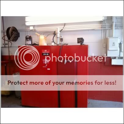

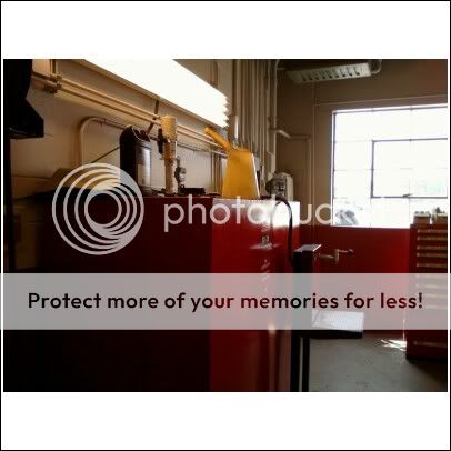

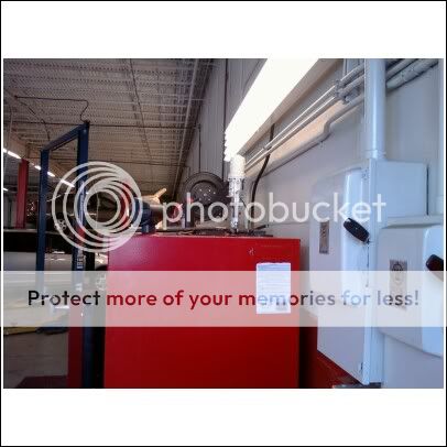

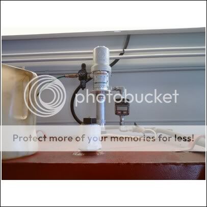

    Here ya are Jayman:

    A standard steel tote bin system, from the looks of it. I had mentioned desiccant breather, here is an example of one I frequently use and recommend
    http://www.descase.com/disposable-desiccant-breathers/
    The desiccant changes color to let you know when to toss it out. It looks like your tote bin has a standard steel breather vent. If it is a desiccant breather, how do you know if the desiccant material is saturated and used up? They don't last forever, usually 6 months max, sometimes a year in good conditions
    If I had to rate your tote bin system, based on my experience in fluid contamination control, I'd flunk it. Here is why:
    I'd like to point out the top of your tote bin has appreciable dust. If that is a regular breather vent, dust is being aspirated into the tote bin as the fluid is drawn down. The pump appears pneumatic, where is the inline water/oil filter for the shop air?
    On the topic of preventing fluid contamination, that opaque fluid container on top of the tote bin, is it used for oil or for coolant?
    If it's used for oil, since it's sitting on top uncovered, and looks dirty in the photo, any free dust or moisture in the shop will automatically be attracted to the container. The proper method of storing small oil containers is to keep them in a clean airtight cabinet, usually fire rated, that is equipped with o-rings on the door seals.
    If that container is used for coolant, which I'm guessing it is since what appears to be a jug of Toyota coolant is next to it, that automatically flunks fluid contamination control. The breather does not look liquid-tight. If the jug of coolant were to tip over and spill, you could introduce ethylene glycol into the tote bin
    It looks like you have the tote bin set up with a digital totalizer, an air/venturi pump system, and a small dispensing nozzle/table. Where is the inline filter for the dispenser? Where is the dust cap on the dispenser nozzle??
    I'm not trying to s*** on you, just pointing out items I would never allow if I were on a contract, offering my services. Consider this a valuable learning experience, and I'm not even dinging you for billable hours. Here is some reading material:
    Designing the Optimum Lubricant Storeroom
    Lubricant Dispensing and Storage Systems
    Lube Room Challenge
    Lubricant Dispensing - What Not to Do
    Lube Room Challenge
    What I would recommend, based on the photos:
    The most obvious change, installing a desiccant breather/filter on the tote bin, with a clear cover to provide visual confirmation the desiccant material isn't saturated/used up, would provide the most benefit. I've already provided a link to the desiccant breather/filter I recommend. Figure about $120, should last a year or so
    The next most obvious step is to prevent cross-contamination. Never, ever allow other fluids on top of a tote bin. If the other fluid should happen to leak, you could contaminate the tote bin. A strict no-no
    Third, keep the dispenser tip COVERED unless in use. A variety of manufacturers offer little plastic tip covers, some reuseable, some disposable, that look like little condoms. A box of 100 disposable tip covers is typically under $35.
    Fourth: consider an inline 5-10 micron filter to the dispenser spout. It's general lubricant good practise to provide an inline filter to a pumped lube dispensing system
    Fifth: That tote bin looks like metal. There should be a draincock on the bottom, it's a good idea to drain a quart or so monthly, to verify no rust, dirt, or water in the oil.
    Oh, you should NEVER store bulk lubes that close to electrical disconnects. In most locales, you'll violate code for doing so
