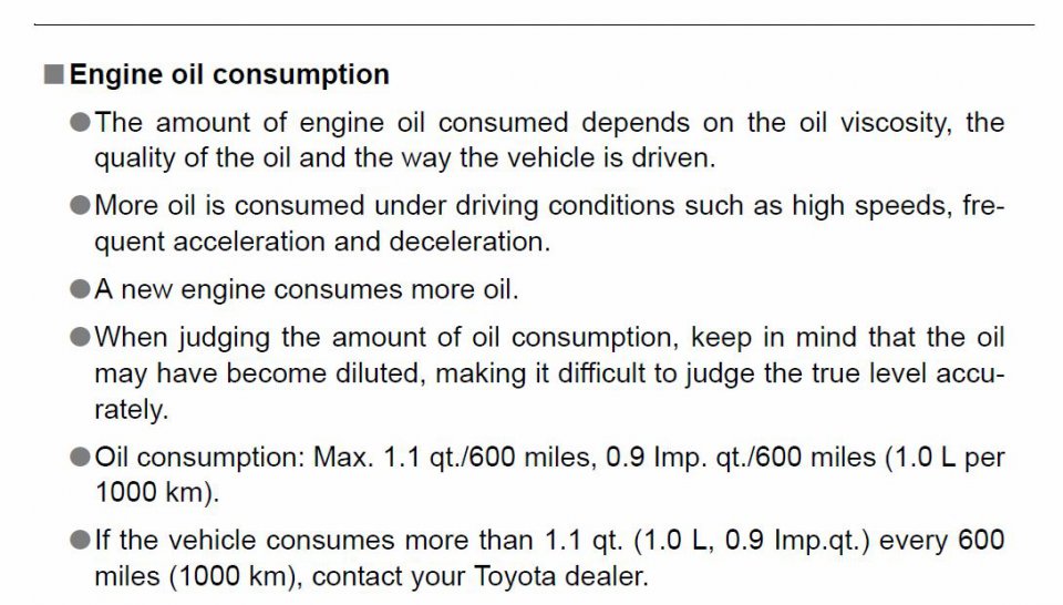

    If your vehicle were brand new and exhibited this level of oil consumption, you would not have a warranty claim (see below). Just add oil as needed, still using the best oil, and check back at 250K miles.

    It basically means there is no warranty whatsoever on the oil control rings. This is about standard industry-wide, except for more allowance for oil consumption in Prius. Typically, it's 1qt/1000 miles.
