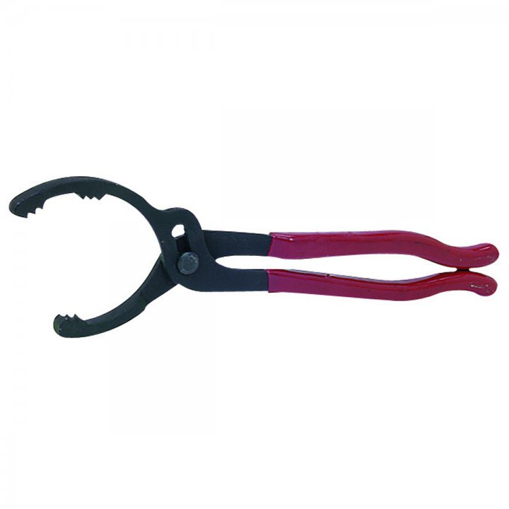

    Hey Mendel,
    This is what I used for removing my Honda Oil filter :D much better grip haha
    2" to 4-1/4" Oil Filter Wrench
