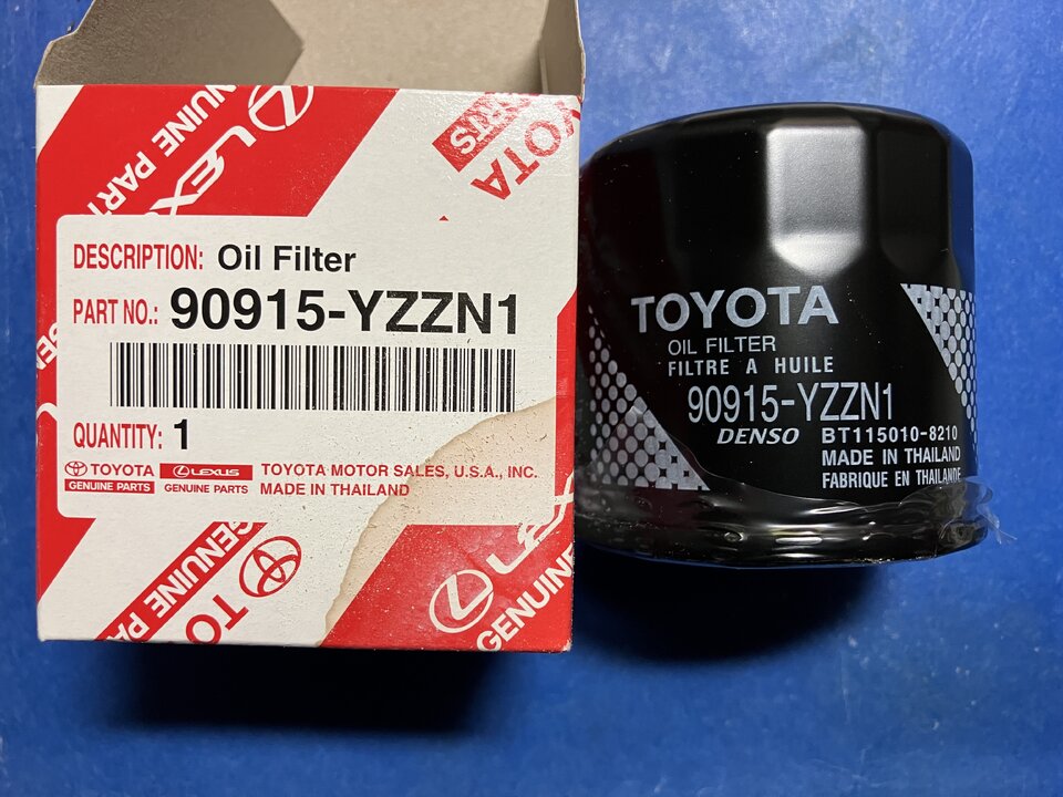

    90915-YZZN1 is what I'm using (on a gen 3 converted to spin-on style). I'd suspect the "65/67mm 14 flute cap wrench"; is it thin, stamped-steel? It should nestle in the 65 portion.

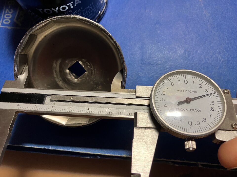

    Honda's standard automotive oil filter socket (aka "oil wrench") is what I'm using, bought in a previous century for a motorcycle, when their automotive oil filters were larger. It's heavy-gauge, stamped steel, very durable, and perfect fit (for Honda, Toyota, Mazda, in my experience). Any Honda dealership could order it in.

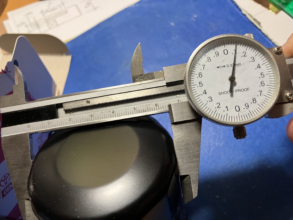

    I happen to have a filter on hand; the face-to-face dim of the flutes is 64.1 mm, for what it's worth. And the inside face-to-face dim on the oil filter socket is 64.4 mm.
