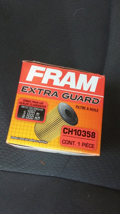

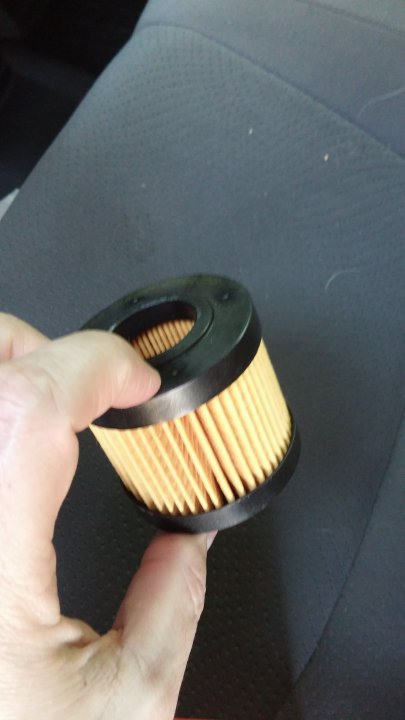

    Hello all,
    Well i have to do my first oil change on my 2014 Prii. I noticed that a factory oil filter is just a paper filter with nothing on the ends. I went to my local autozone/parts store and the FRAM filter has rubber on the ends. Is it ok to use that type of filter, does anyone have experience with FRAM oil filters on the prius?
    Thanks.

  4. Yakoma
    Yakoma Active Member
    Oct 17, 2014
    470
    125
    sss
    From your description, the Fram doesn't sound like the right one...got a picture?
  5. CdotK
    CdotK Member
    Aug 7, 2013
    376
    46
    i do...

  7. CdotK
    CdotK Member
    Aug 7, 2013
    376
    46
    Thanks for the response. Just had me worried with the rubber end.
  8. CdotK
    CdotK Member
    Aug 7, 2013
    376
    46
    Update. Everything went well, filter fit fine, car runs fine.
    Removing the oil filter cap.. That was a pain in the butt.. It was so tight i thought i was going to break my wrench.
    Thanks for all the help.
