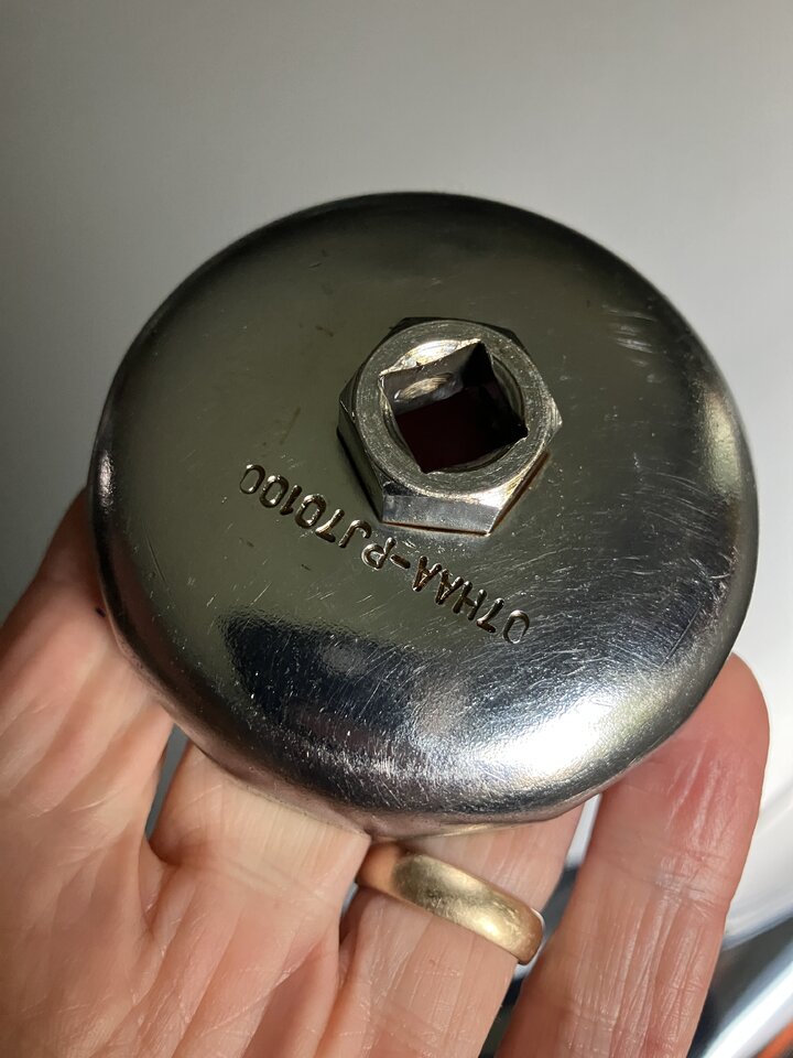

    That looks distinctly different than mine, fwiw:
    (embossed number different as well, but maybe normal, since from 1990)

    Yes, and preferred. The ones with "fin engagement" tend to break off the fin, because they engage the fin before the 14 flutes.
