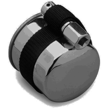

    My Gen 3 with the replaceable-element filter is the first car I ever bought a bespoke oil filter wrench for.
    Up until then, my one decades-old oil filter strap wrench has removed every oil filter of every size that I've ever needed to remove, and also turned pretty much every other random object I have ever wanted to turn. It's a pretty versatile tool.

  16. ChapmanF
    28,756
    19,063
    Just the Right Size Every Time:
