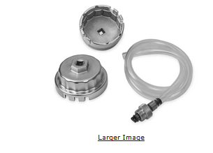

    Since we're all having fun, I went to Snap-on and found their wrench. Here's the picture, above. Note the cut-outs in the edge of the two wrenches (they're two different parts) that engage with the lugs at the back of the oil cover. They're $33, according to Snap-On's web site.

    I had a horrible experience with changing my 2012 Prius Plug-in filter. Went to Toyota, got the "recommended" filter cap remover (with the tongs as shown in picture by kbeck) and it would not wrap around the filter cover. Then went back to Toyota and got their "cheaper / thinner" remover which did not have the tongs.
