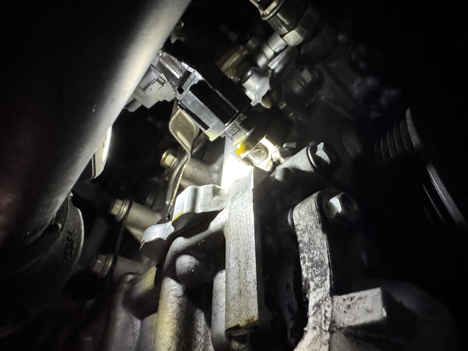

    So, I took out the bottom cover and cleaned everything. As usual, the actual effort took less than 5 minutes. Most of my AM was spent on trying to find my 10mm socket :)
    It turns out that the leak is from the crankshaft position sensor. That means I hold a 100% track record of misdiagnosing a car issue at first glance.
    I had also put in a UV dye. (will add the photograph when I crawl back under). The leak is definitely coming from the crankshaft position sensor.

    Thank you. I think the problem is fixed. Here is what I did:
    1. Looked for the o-ring for the Crankshaft Position Sensor from Toyota. Turns out all the references for the o-ring for this part were Google hallucinations, giving me a different part.
    The Toyota parts guy in Palo Alto sat down with me, compared the o-rings, and we realized that Google lied to me.
    2. Auto parts store O-Ring: Went to Kragen (O'Reilly's) and they had a similar O-ring, a bit thicker, though. Used that.
    Result: I saw a smidgen of oil after driving 12 miles. Could have been due to residual oil somewhere
    I was taking no chances.
    3. Installed a new Toyota (Denso) part. Test drove it; no leak. Reinstalled the bottom plastic cover. 1 bolt is missing, and I have an extra push tab left over :)
    4. Drove around 100 miles over the weekend. There doesn't seem to be a leak, but I did see almost a trace of oil. I cleaned it up all over again. Will check weekly.
    It has been a fun project. The most important thing I learned was that starting with a super clean engine area is crucial.
