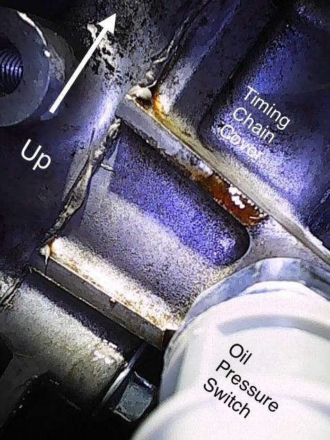

    Recently found out that oil has been leaking from the oil pressure switch on my Prius 2010 Base model.
    Took it to the local toyota dealer who provided Pressure Switch replacement estimate of $500. Also suggested may be leaking from timing cover (estimate $3553).

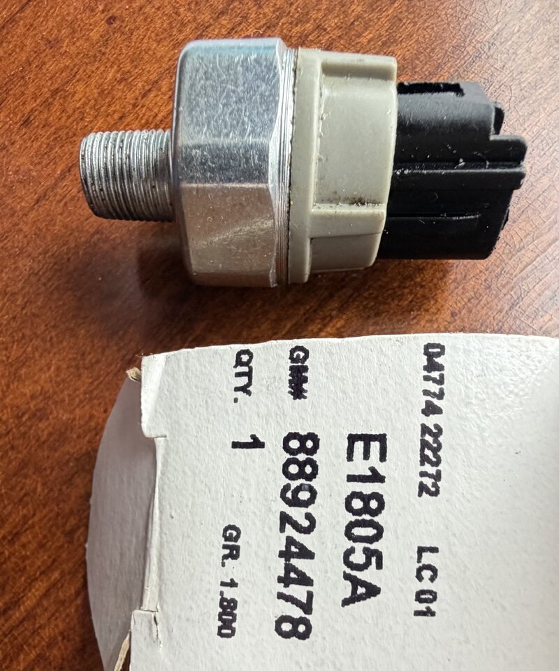

    Based on online research it looks like the pressure switch runs around ~$65.

    1. What are my best options? anything worth DIY for generally savvy with fixing with tools.
    2. How bad or urgent is timing chain cover replacement fix?
    3. The oil pressure sensor switch replacement cost: Is it reasonable given the labor + part cost in Northern NJ. Also hoping this is the major issue so if fixed I can continue using for short distance commute.

    if the pressure switch leak is significant and bothersome, go ahead and replace it.
    for the timing cover, it's usually very small and not worth repairing. they all leak
