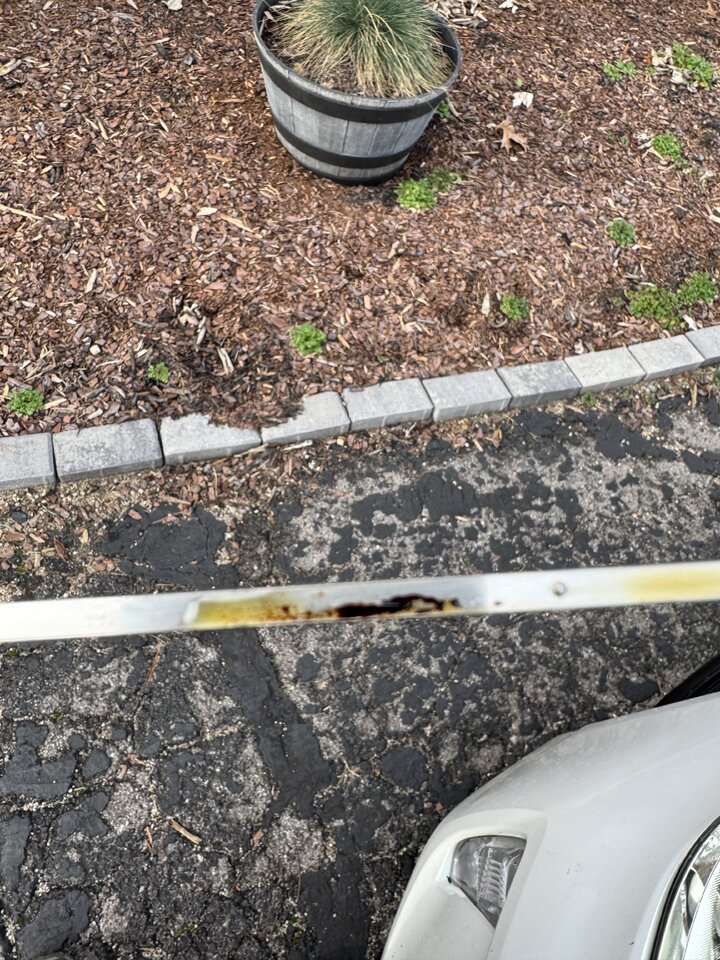

    Nothing too important here. Just some conversation. Wonder what these burnt places are on the dipstick. For perspective my car has 360,000 miles and in the last year it has actually stopped burning oil , or I will state I don’t need to add any between 5000 mile changes. I use the restore and protect and everything is going well but I have noticed these burned oil places on the dipstick and I've actually cleaned them off about a month ago and these are new. What do you think this means? Is this normal?

    When my persona was doing that that. That crusty shiet on dip was coolant hardening . Smelled like it tasted like it . Coolant that is . And sure enough about 3 weeks later the rattling and HG issues started . That was end of that .

    I have posted on here that I have had periods of infrequent coolant loss and some knocking. It seemed to happen several days in row- lost maybe several ounces of coolant . Hasn’t done it in a couple of weeks. I did clean the EGR cooler, manifold, replaced PVC. Maybe that helped, I don’t know anymore.

    "Burned"?? Is that stuff easy to wipe off? Could it be from carbon deposits liberated by the Restore and Protect? It might be interesting to see what your oil filter has captured since you started using it.

    You would have to scrape it off with your fingernail or a plastic scraper or something .

    I clean my dipsticks with a Scotch-Brite pad till clean n silver

    If the dipstick is burning, so is the rest of the engine...... :whistle:(y)

    I was checking something today and noticed the following:
    When engine is cold- and you release the reservoir cap, there is a hiss as if it is under some amount of pressure. Some of this is normal, or is it?
    I started the car and let it run for a bit - I noticed 2 things I had never noticed before-
    When the gas engine shut off, the engine fan came on for a bit.
    I can hear the water pump running with the gas engine off. The engine temperature, according to my scanner app was only 110%.
    It sounds like a head gasket failure all the way around just wondering about the last two observations? Any thoughts?

    Ugh, the plot thickens. Borescope inspection?
    BTW, should 110% read 110C?

    That's how you can have a little heat while stopped with the engine automatically shut off.

    That is some kind of oil deposit and/or varnish. If there is that much on the dipstick, you can only imagine how much there is in other places in the engine.
