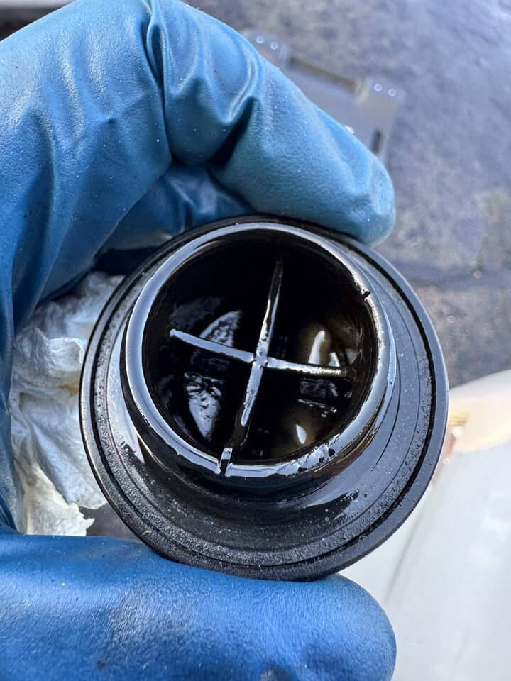

    Me again. Just changed the oil and noticed for the first time a little snot looking globule on the oil filler cap- is this what the experts call the “oil milkshake?!”

    Combined with your coolant loss and occasional rattling its not a good sign.

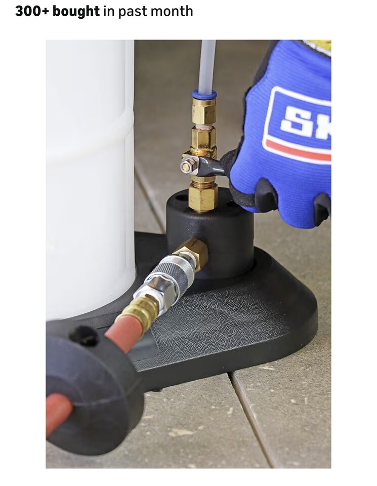

    Believe or not, vacuuming up the oil through the dipstick can remove more oil than draining. It is also useful for every other fluid. It does take a decent compressor to operate the venturi created vacuum.
    CR94 likes this.
