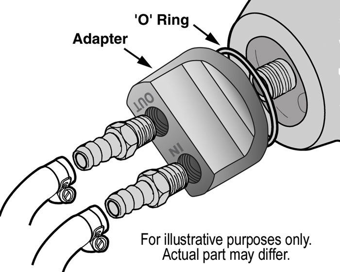

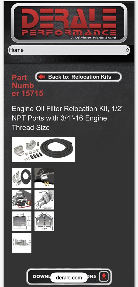

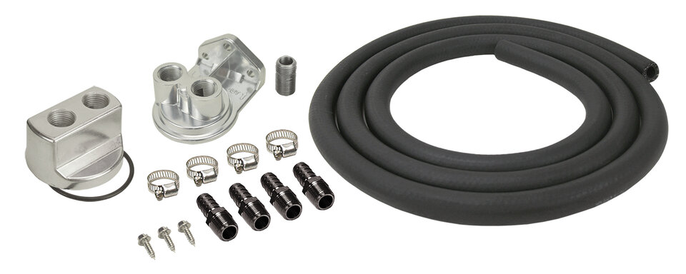

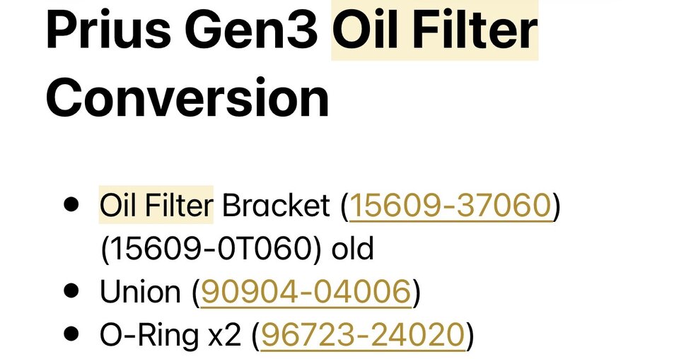

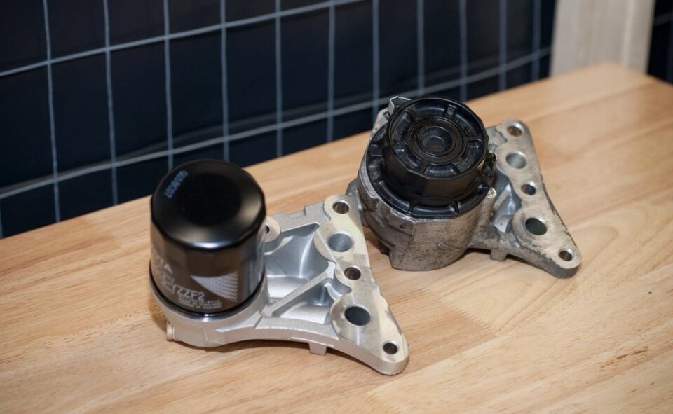

    The way to do it with off the shelf parts is to first convert your gen3 to a standard spin on filter using 2018 gen4 oil filter housing parts
    and then use a universal remote mount kit for the 3/4"-16 filter thread
    Brian1954 likes this.

    I did the oil filter conversion to spin-on, but can't get my head about why you'd want to shift the filter location: at least if you're under there, doing a conventional oil change, it's right there, and not going to drip on anything. If you're thinking to vacuum the oil out through dipstick it'd make more sense, but...
