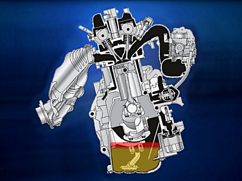

    Thanks for posting the picture. From it... I conclude that red oil is less dense than brown oil. :rolleyes:

    :) THANKS ScottY...
    ...for posting that ICE cross-section showing oil levels. That's the VERY BEST illustration of why to NOT overfill the ICE oil.

    Here's an update on my personal situation. I stopped by the auto parts store and picked up a filter wrench. Took off the filter and drained about a cup of oil from it. Ran the engine, checked the level, and PRESTO! I'm below the line. That's such an easy fix, even a newbie like me can do it. Didn't even jack up the car.
    BTW I Love the picture, although I thought it was some sort of Transformer robot when I first looked at it! :lol:
