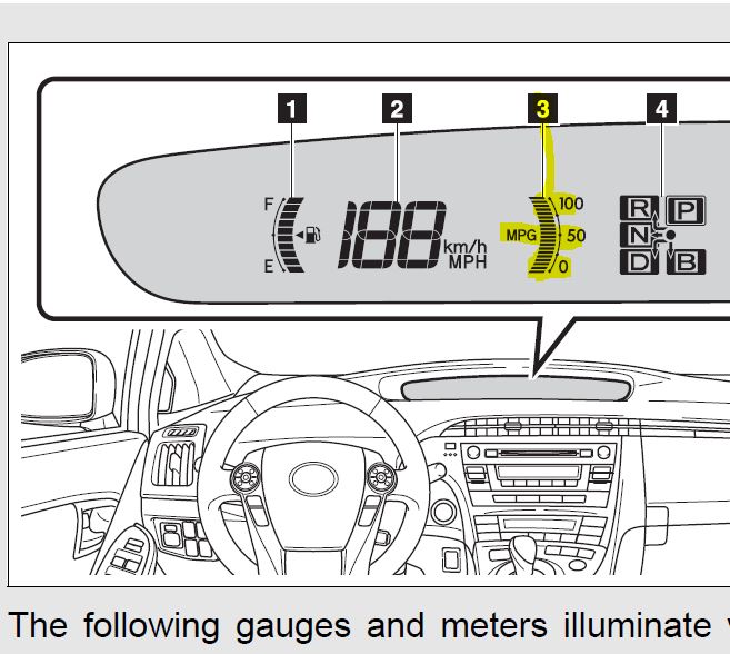

  14. Mendel Leisk
    61,322
    42,202
    This is on the hatchback, but I'd assume the v is similar:
    If you're stopped at a red light, the mpg indicator is going to tell you you're doing infinitely good mileage. Even if the engine comes on, it'll continue saying this.
    Nothing could be further from the truth, but in that situation the gauge is irrelevant, so it's just shut down.
  15. Air_Boss
    Air_Boss Senior Member
    Jun 2, 2012
    4,238
    1,192
    New Yawk
    The v displays that, ICE on or not, MPG at rest is zero.
