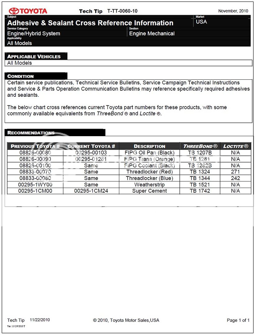

    Is that thread sealer purchasable at dealer (Toyota genuine adhesive 1344) or is locktite 242 (blue) usable, in high pressure and oil environment?
  5. frodoz737
    frodoz737 Top Wrench
    Aug 26, 2010
    4,804
    2,560
    Loctite 242 is equivalent, more readily available, likely cheaper and legal with Toyota.[​IMG]
