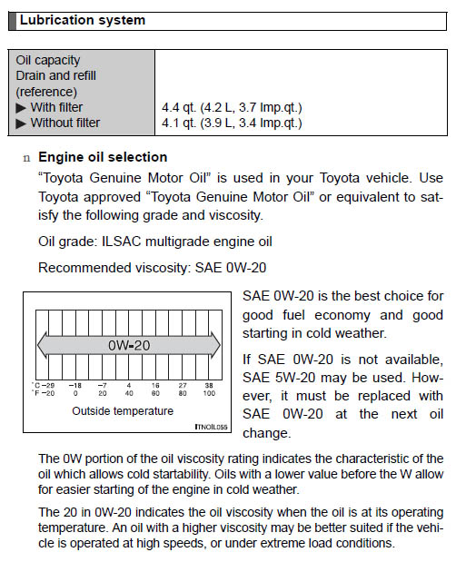

  11. Mendel Leisk
    61,465
    42,296
    I don't think there's a correlation between synth and the (US) 10,000 mile oil change interval. All the (North American) Owners Manual says on the subject is a recommendation to use 0W20 (no mention of synth, though it very likely will be), or 5W20 in a pinch.
    And in Canada Toyota still sets oil change interval at 8000 km (5000 mile).

    According to the manual, you should use full synthetic 0w20 oil. You can also safely use 5w20.
    If you also look on a page 39 of your warranty and maintenance guide there is a note that says "If 0w20 WAS NOT used at the last oil change, replace engine oil or oil filter." In other words you can pay twice as much for 0w20 every 10,000 miles or you can save half as much using 5w20 every 5,000 miles.
