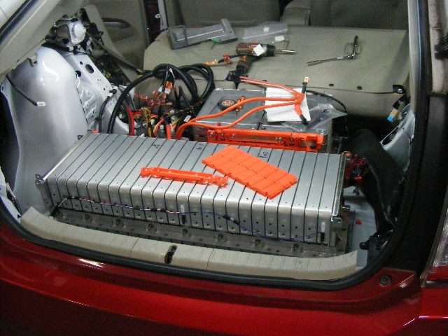

    Snake oil, with plenty of outright lies. While claiming to fit in the factory battery case without modification, the only in-car picture shows something vastly larger than the factory case, and unfinished. The other pictures show something larger still, that won't fit in the trunk.
    The only in-car picture is of a Gen2. Your Gen3 is different.
    The only way to get a Gen2 or Gen3 non-plugin Prius to 120 mpg is to convert it to a plug-in, and play games with the number of miles driven on plug-in EV miles. It cannot be done on gasoline alone, at least until (approximately) Gen-10.

    There are companies swapping Nissan Leaf packs in place of the Prius HV pack. But it certainly would cost more than $2,700.
    I'm not quite sure what is going on in the photos. That's quite a bundle of wires. leaf prius pack.jpg

    And whatever that wire bundle is, it is not completed
