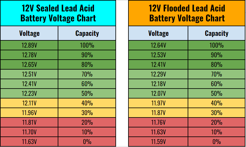

    Do you have a good multimeter? What is your open-circuit voltage? If you can't measure the open-circuit voltage, a low-load voltage measured at a current of less than 0.45 A should be sufficient. If it is about 12.8 V, then you have a fully charged battery. Note that immediately after charging, the voltage could be higher; so, wait for about an hour after the car is driven or the battery is charged from a charger.
    Note that according to Exide, the open-circuit voltage at 100% SOC is 12.96 V (2.16 V per cell) or perhaps 12.84 V, but this seems to be the value for an AGM battery. The open-circuit voltage at 100% SOC for a flooded-cell battery is probably more like 12.64 V.
    https://exide.sk/asset/uploads/na%20stiahnutie/NEW_Exide_Edition5_TechnicalGuid.pdf
    The following information for AGM and flooded-cell seems reliable:
    Lead–acid-battery voltage chart
    Moreover, I probably wouldn't want to use an AGM battery in Gen 4/Gen 5 Prius/Prius Prime because the voltage-vs.-SOC characteristics would confuse the battery sensor, especially at a higher SOC.

    In your simple battery monitor, which is probably only a voltage sensor, the SOC is probably looked up from an SOC-vs.-voltage table like the one I posted above. So, the SOC is calculated directly from the voltage and not independent of it.
    I don't know how the battery sensor in the car does it. The battery sensor measures both the voltage and current as well as the temperature. So, it probably uses all of the voltage, current, and temperature to determine the SOC, as the SOC-vs.-open-circuit-voltage relationship depends on the temperature, and knowing the current could be helpful for determining the SOC, too.
    The long story short, look at the voltage values in your monitor with the car turned off, and then use the table I posted above to estimate the SOC. I don't think the SOC estimates of your monitor are correct.
