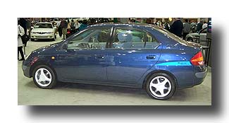

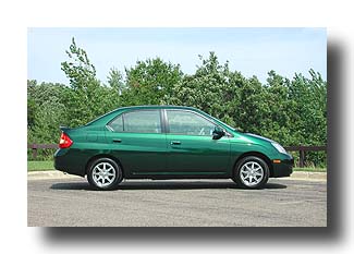

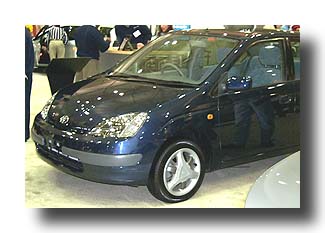

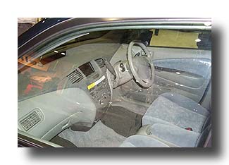

    I thought this was going to be about a True Japanese Gen 1 with cylindrical cells from the late 90’s being imported
  7. john1701a
    john1701a Prius Guru
    Jan 6, 2004
    12,840
    5,312
    That Prius is known as Gen-0. Since the more advanced programming languages start counts at 0 rather than 1, combined with the fact that it was never offered for sale here, that drew attention to being distinct. It was also an interesting debunk approach to the on-going problem exacerbated from antagonists claiming Prius was rolled out in 2000, attempting to mislead by referring to that as Gen-1 instead. They worked hard to make sure no one would find out how much Toyota had already upgraded their hybrid system by the time it made it to the United States for sale, 3 years later.
    I had the opportunity to see that original, back in April 2000. That design came before the prismatic battery-cell. It looked a bit different on the outside. On the inside, the screen wasn't touch-sensitive. The engine wasn't as powerful either.
