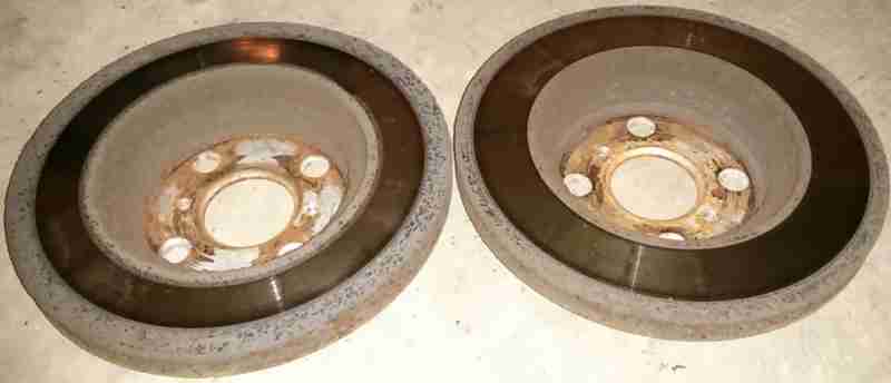

    My trivial rust buildup, ~100K miles. Pads are still about 4mm thick and uniform edge to edge. Not a big deal. I don't mind replacing pads and rotors. Yes, I should have caught this sooner. This is just the first time I have personally rotated tires in quite a while (thanks, COVID). Usage of this vehicle has diminished from about 10K miles per year when it was new, to about 5K now. I will use genuine Toyota parts since I don't want to have different pad compositions between front and rear. Rear brakes/rotors were done about 2 years ago with genuine parts. All sourced from Olathe, if I'm allowed to say that.

    Also (FWIW): NAPA sells an 'ultra premium' rotor that is coated with a polymer. The pads remove the polymer where they meet the rotors upon first application, so ostensibly the rotors don't rust as seen here (and on mine). I bought a pair, but did not install them, as the rotors were still in spec. They are about 40USD each for the front rotors. Bonus note: when I was deciding whether to buy the car, I took it with the blessing of the seller to a local Salt Lake (big, fancy) Toyota dealer to have it run thru one of their '72 point' inspections. Came back with a good score, EXCEPT they said the REAR rotors were out of spec (pretty much impossible with that mileage...) and that the CV boots were torn, and front axles needed to be replaced (boots were intact and perfect...).

    Happened to me with my Gen 1, got pretty bad, ate up the edges of the pads:
    Have not noticed it on my Gen 3, so far.
