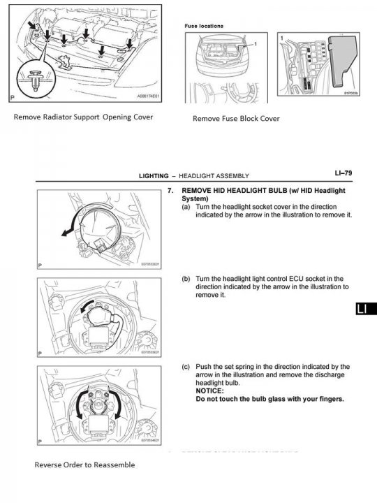

    Dealers say they have to remove the bumper cover to do it, about $200-$300. It's not so. You can do this yourself if you have some manual dexterity and hand strength. Luscious Garage website has a video of this and blogs of many useful Prius tips. I've attached instructions. I recommend Sylvania/Osram or Phillips D4R lamps. Prices are going down through Amazon.

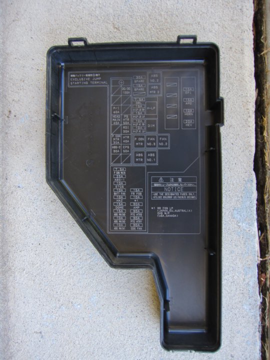

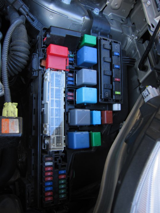

    Check fuses 26 (Right lo-beam) & 27 (Left lo-beam) in the engine compartment first. Both 15-amps.
    Make sure they're good and fully inserted.

    Toyota Prius: How to Replace the Headlight Bulbs (HID and Halogen) - PriusDIY.com
    With a couple basic tools like a Phillips screwdriver to remove the radiator support cover you can replace the lamps.

    It is a little difficult doing the lamps if you're not a do-it-yourselfer. The fuse box is pretty easy. Just pull out on the back of the cover on both sides and it will come off. There is a white fuse puller on right side below the 4 fuses located there. There is a diagram of the fuses and brief description on the inside of the fuse box cover. You can just pull 26 and 27 and see if the filament is burnt. There is usually a spare 15 amp in the center row near the top. 15-amp are light blue.
