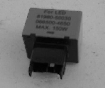

    Has anyone tried the WebElectric one touch module?

    Got my webelectric one touch relay yesterday, installed it on my Sienna pretty easy (located just behind the fuse box when removed the knee air bag cover). Tried to located it on my Prius but seem pretty hard to get to like someone point it behind the top dash. Will figure out before order another one for Prius.
    Work like advertised. However there is one glitch: the first turn signal on pause for a second before it start flashing, just like some cheap regular LED relay on vleds. Email the vendor and still waiting for reply.

    . I have used 2 WebElectrics relays with no problems. The last one I put in, I left the original relay in place and hung this one separately. Neat things about WebElectric relays: LED ready and programmable! I set mine for 4 flashes. Seems to work better then 3 flashes for me. This is the first mod I did to my new Prius, and then the horns!

    Really hard! I tried few times with hazard flashing to locate the relay by the clicking sound but unsuccess. At least a good portion of the dash bottom need to remove to gain access.

    Is it pausing for a second when first turn on?
