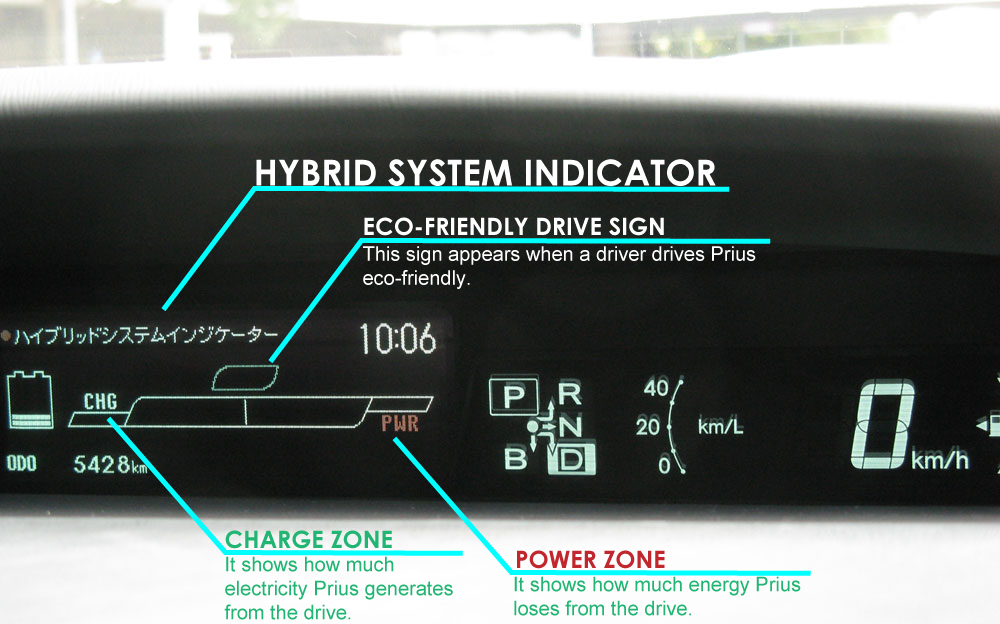

  14. Maarten28
    Maarten28 Active Member
    Jul 13, 2014
    415
    224
    Netherlands
    What do you mean with the "charge bar"? The thing labeled "charge zone" in the picture below, or the vertical SOC bar to the left of that (above ODO)?
  15. Iketorz
    Iketorz Junior Member
    Oct 7, 2018
    46
    Yes the charge zone, the one that moves to the left when you hit the brakes. I wasn’t talking about the battery level indicator in any way.
    #55 Iketorz, Nov 7, 2019
  16. Iketorz
    Oct 7, 2018
    46
    You misread what I wrote and then twisted it to act like I was "wrong." I was talking about the CHG zone, not the battery state of charge indicator.
    I was talking about the charge indicator moving to the left (hence my use of key words such as “charge” and “to the left”), not the battery level (hence my having not used the words “battery level” or "state of charge" at all).
    I thought that referring to the charge indicator moving to the left (since it’s literally the only gauge on the MFD that does that) was enough to be clear but it appears I was mistaken.
    I just put that in as an aside to help other Prius owners and you turned it into an opportunity to be condescending again, and you weren’t even right. I don’t get what your deal is but you aren’t a helpful person.
    #56 Iketorz, Nov 7, 2019
  17. Iketorz
    Oct 7, 2018
    46
    There's no HV quick charge happening. The vertical battery level (or charge level) doesn't fluctuate very quickly. I was just talking about the horizontal gauge that goes left (CHG side) to right (PWR side). I was talking about how the brake causes it to move. I'm talking about the CHG in that picture up there moving when you hit the brakes.
    To further clarify, there is nothing wrong with the car right now (I literally just got it back from the dealer and posted a comment about how everything is working now), and I was just putting that aside on the end of my comment so that other Prius drivers would know how to diagnose inoperative regenerative braking.
    #57 Iketorz, Nov 7, 2019
    dig4dirt likes this.
