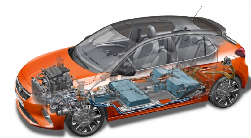

    And another thing i REALLY dont understand... WHY do car manifacturers keep building EV`s like their ICE? has Engine in the front, strange battery placements and so on... Mercedes does the same with the EQC... Its like theyre not designing the car as being an EV, but being an ICE...

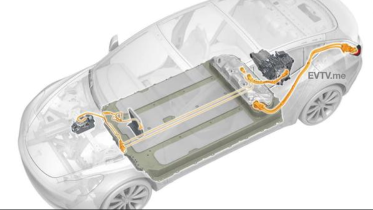

    This is the model 3 for comparison, its actualy designed as being an EV, while the Corsa is still designed as being an ICE. (in a car as small as the corsa i do agree it is smart to split up the battery into different pieces so they dont affect rear "leg room-hight" tho.)

    There's nothing inherently wrong with the packaging of this car and I really don't understand why it's a point of criticism. Because it's a FWD car, it makes sense that the whole motor, transmission, and cooling package sits up front under the hood. The powertrain layout also suggests that unlike the Model 3, it likely has a spare tire rather than the old pat on the back and "good luck, bro" you get with cars with no spare (in our case, the Prime and our Model S).
    A follow on question regarding strange battery placement: where should the battery be exactly? The batteries of both cars are located in essentially the same place - across the floor of the car, within the wheelbase.

    It is because they started with a FWD ICE platform. Easier to keep the motor in the front than to re-engineer the rear end for it. It is lower cost when you don't have dedicated BEV platform like Tesla and VW, but compromises have to be made.
    The Bolt and Leaf use a FWD platform and place the battery in the center, and neither have a spare tire. The lack is mostly about cutting weight for maximum range.
    A BEV platform more efficiently packs in the battery. Meaning more capacity or less space loss. The platform can make better use of space, instead of losing some to unuse. The Ioniq Electric, and apparently this Corsa, have a void in the former engine bay. Tesla turns that space into another trunk, and VW's design is shifting it to the cabin.

    If I had one, I would stick a plastic bin in the space in front of the battery. There is a void there.
    Being an ICE platform, Hyundai made use of the existing engine and transmission mount points. Which means the Electric's set up is mounted higher than it actually needs to be.
    FWD spread because of the efficiency advantage from having the drive train being parallel to the drive axle. Because of cooling needs, it is easier to put the engine in the front. It is easier to mount a motor in the rear than an engine. That, and driving dynamics, is why Tesla and VW's platform are RWD. Every car has traction and stability control now, so the traction advantage of FWD is less. Then AWD is cheaper to do on a BEV, and might be more efficient, so many BEVs will likely be equipped as such.
    The only potential downside is regenerative braking efficiency and performance.
