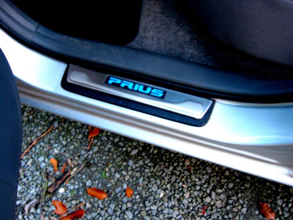

    Sam something you might be interested in at a later date when we have solved your problems.

  19. Sam Dean
    Sam Dean Member
    Jun 12, 2013
    255
    wow - those panels look sweet!
    What's their functionality?
    I was thinking of fitting a door lamp at some stage, so when you open the door at night, you can see all of the floor around the entrance of the car. My friend has this function on his Range Rover Evoque and it looks slick.
    I was also thinking about (not 100% yet) putting vinyl wraps on the car. The body work is okay but its been painted over, and although it looks lovely to me - the trained eye can very quickly spot that it's a poor paint job :(

    Britprius Senior Member
    Jun 14, 2010
    5,194
    1,924
    Herefordshire England
    They are lit but although very bright at night are only noticable in daylight. If you put bright LED's in the door lamps the Prius does that the OEM bulbs are to weak but you cannot use larger ordinary bulbs because of the heat produced. Another mod is to put LED spots in the bottom of the door mirrors wired to the curtesy lamps so they come on when you unlock the doors remotely.
