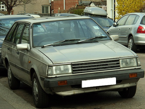

    Got any pics of the sunny? had one myself but cannot remember what year.

    this is pretty freaky but basically, i couldnt find any pictures of it locally and so i thought i'd search the web for it, and i came across a picture of it, with a back-drop which looked like my road....and lo and behold, it turns out my poor car is famous and online! LOL!
    i wonder who took this picture - hmmmm
    This must be quite an old picture because the bodywork looks more like a faded brown and has abit of rust developing around its body.
    hope ya like it - it was given to me by my father as a "run-around car". It's as solid as a tank - passes MOT everytime!

    Yes thats the same car that I had except mine was the hatchback, I also had a Nissan Bluebird a great car in it's day. The engine was so well sealed everything under the bonnet that was not painted was going rusty including the oil sump.

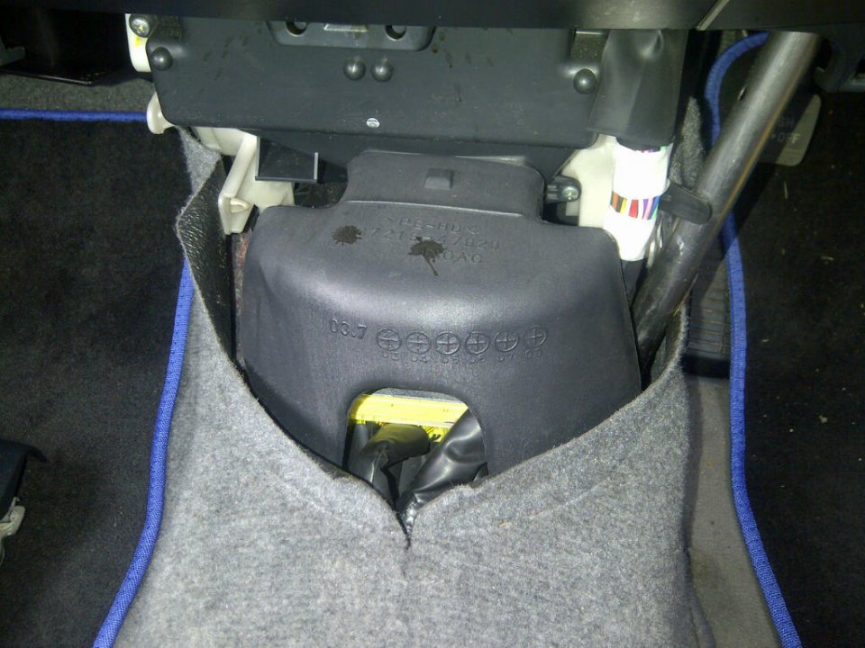

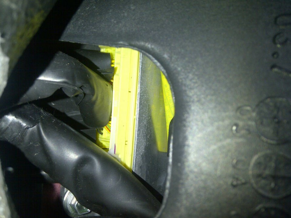

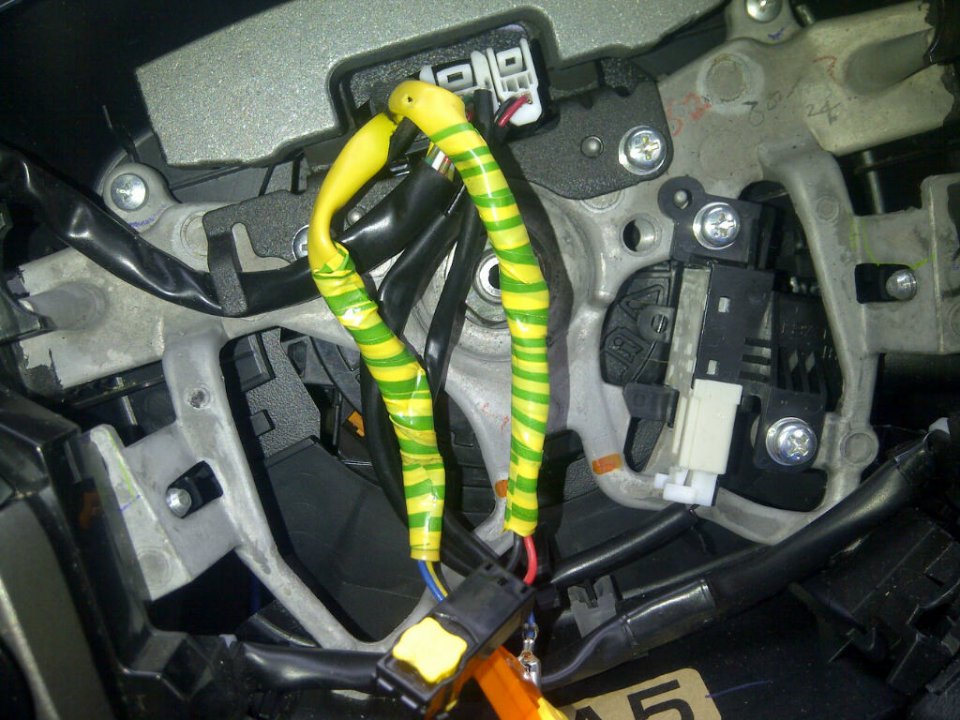

    Okay, so I got the air bag compartment out and disconnected the connectors. These looked in good condition but I noticed that the actual cables with the airbag connectors had a green and yellow tape wrapped all around them. This looked alittle alarming straight away.
    I am attaching a picture of the cables with a green and yellow tape wrapped around them, along with the ECU compartment in the middle, under the central part of the dashboard - the first picture being a distant shot and the 2nd one being a close-up through the gap - I'm assuming that this unit at the bottom (through that gap) is the ECU? It looks like it has lodes of cables coming out of it....I also couldn't see an easy ways to remove this plastic cover - but to be honest - from seeing the condition of these airbag connection cables, I think we can see the culprit. Is there any way to test these cables locally instead of going all the way down to the ECU with the multi-meter?

    Sam, Am now away on holiday and have found a WiFi hotspot but it is a bit intermittent. It certainly looks like you have found the problem "that to be honest I suspected all along."
    In picture one with the two taped up cables should have a plug on the other end (next to the two white plugs at the top of the picture) Is it still there and can you unplug the cables at that point.
    This is the connection point to the top of the clock spring. This cable (pair) can then be replaced either new or second hand from a breaker.
    Alternatively if the plugs on both ends of the cables look to be in good condition, send the cables to me and I will repair them correctly and return them to you. If you decide to send them to me send them straight away and when I get home next weekend I will repair and return them first class on Monday.
    This I'm afraid looks a real botch job, but it can be fixed. Will continue in about 30 minutes.
