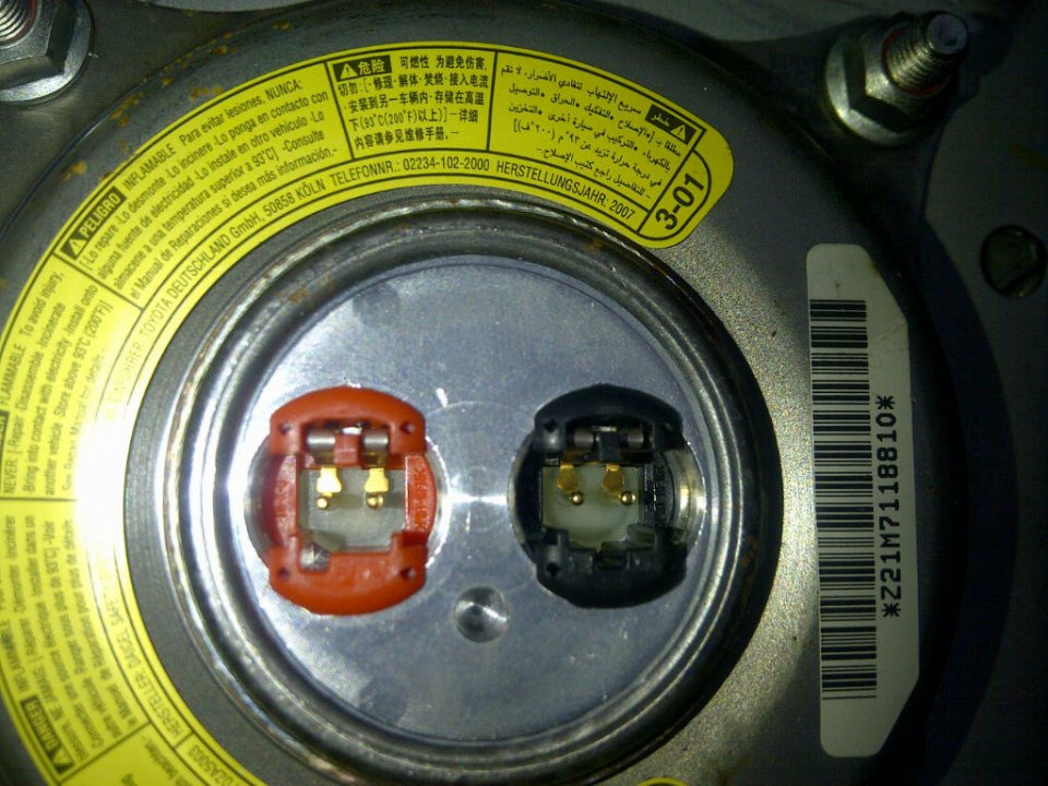

    hmmm - shall i take a photo of the connections on the actual airbag? and also maybe a close-up of the black and orange connectors?

    Yes Sam this does point to the Black connector where it fastens to the air bag, the only other explanation is the air bag it's self and my money is on the connector, (famous last words) this is good news.
    Did you put the paper clip on the side of the connector that goes to the air bag or did you push it into the back where the wires are connected.
    Some close up pictures of the air bag terminals and the side of the connectors that go on the air bag could be useful.

    thought i'd upload a picture of the connectors on the airbag just for good measure...
    these airbag units looks quite expensive
