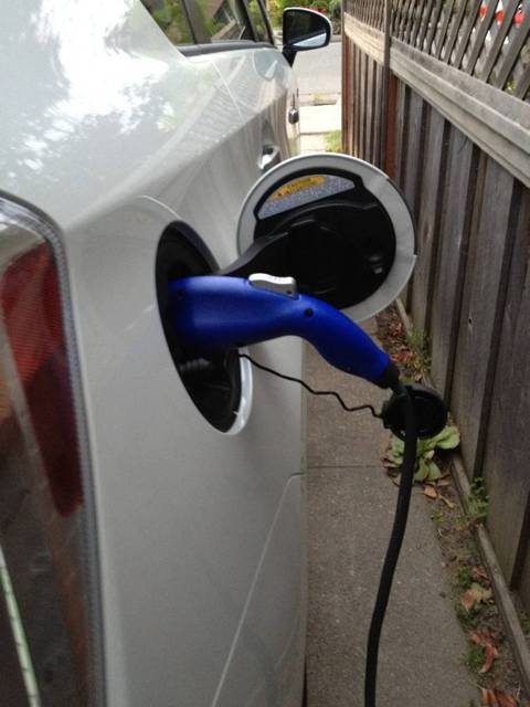

    I finally finished my OpenEVSE build this weekend and I am happy to report that it works excellent. I was able to build this for under $400. I used the Arduino Uno 3 with the OpenEVSE Shield and Adafruit RGB display all stacked together. All in all it was a great experience building and finally watching it work. Thanks to all the examples on the OpenEVSE site that I used to model mine after. You guys did all the heavy lifting so people like me could jump right in and set it up. I still need to get a hose caddy for the cable.

    It looks like you used the Levitron cable, right? Is it the 30A?
    How does it fit in the car? The one I ordered is a very tight fit.

    That is correct, it's the 30A cable. It seems to fit fine, snug but I have no issues hooking it up or removing it.
    To answer bisco: I ordered the components back in Sept and put it together in my spare time. I finally had a alot of spare time on Saturday so I just went for it and completed it. I'd say it's about 6-8 hours of work depending on how handy you are.

  16. Rebound
    Rebound Senior Member
    Mar 11, 2010
    3,996
    2,645
    Portland, OR
    Part of my problem is that I have to attach and remove my cable from the rear of the car, because I have to park against a fence. The bulk of the plug and cable is because it's 30 Amp. Same bulk as a the commercial ChargePoint or Blink stations.
  17. Tracksyde
    Tracksyde Member
    Sep 21, 2011
    1,429
    762
    So Cal
    I bought Mitch's previous OpenEVSE with the ITT/Leviton plug and like Rebound, I do think the fit is a little on the tight side (at least compared to the OEM one). However, I was also thinking it is partially because the ITT/Leviton plug's "handle" is less angled.. so when I'm pulling it out, to get enough leverage, I inadvertently apply some upward force.. this causes the plug portion, with its small tolerance, to kind of come out at a slight angle.. so slight that it kind makes it seem like a tight fit coming out.
    I hope that makes sense. I dont know this for sure.. its just that sometimes I feel the plug goes in and out with ease.. other times it seems super tight. Maybe I'll put some plastic cleaner/polish (Plexus) on the plug portion.. I'll see if that makes it more "slick".
