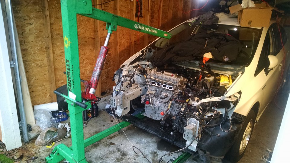

    Okay so the old engine is out of the way. New one just arrived today. Waiting for some gaskets and I am getting ready to install it. But I have two VERY IMPORTANT QUESTIONS !!
    1. So my transmission is still in place. It was pretty easy seperating the engine from it. The question here is do I have to lock them in a specific place when I attach them back together or it does not matter ? I don't see any marks and I am using the Haynes manual and it does not mention anywhere for that ? ..
    2. The engine I bought is with 25k miles looks like brand new(compared to mine after 200k miles) the oil has been drained from it I guess when they took it out from the wrecked car, that could be a year ago. SO the question is what is the procedure to lubricate the engine before I crank it for the first time. I guess I will stop the fuel pump and disconnect the sparks and let it spin for a little bit so the oil pump can lubricate it..Is this a good Idea.

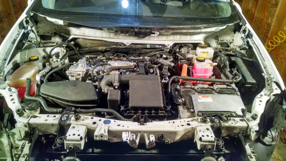

    Ok, finally the new engine is in place. There is one issue and it is a big one. The car won
    t start, I am getting code U0293 which is related to "The Controller Area Network". So it is either a wire harness or the ECU. I tried to clear it with scangauge it won't...I ordered the OBD usb cable used to scan with Techstream. I downloaded the software but I am not sure if it works or not... will have to wait for the cable. ..
    So does anyone thing that this is a code that is stored in the ECU and just has to be cleared or there is damage somewhere....Everything is attached I double checked.

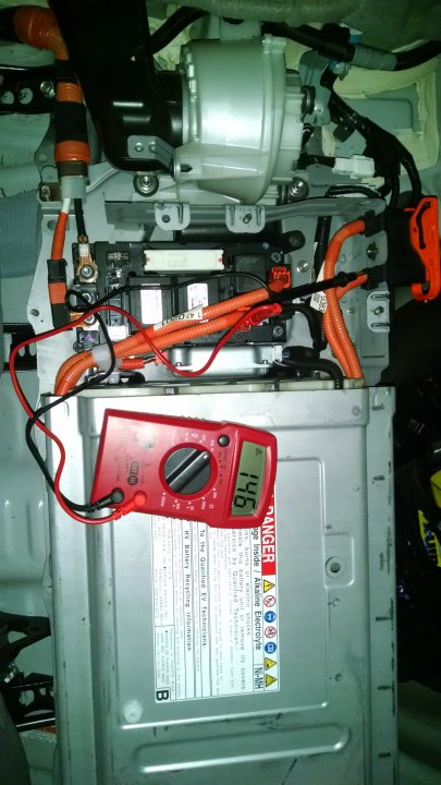

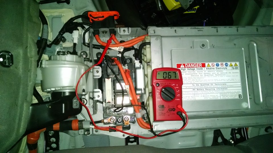

  20. nedim
    nedim Junior Member
    Jul 2, 2014
    81
    Redmond, WA
    Ok this is what I got. Please somebody correct me if I am wrong, but aren't those the two sections of the battery that the service plug separates? So if I SUM the two numbers I am getting 213v which gives me an idea that there is plenty of juice, right ?
