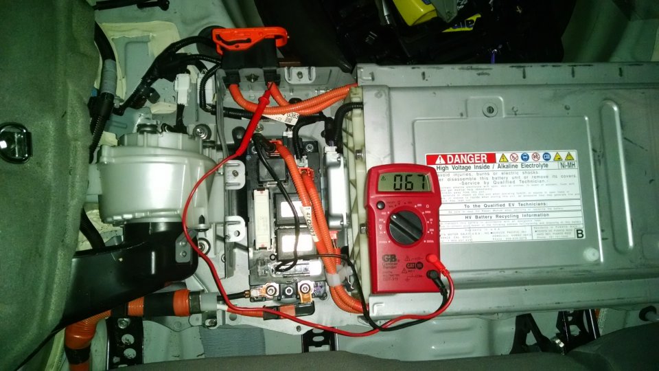

    There aren't that many for Gen3. Plus they are wrong. The end connectors leading to the front of the car will show voltage only if the car is in READY mode( which I can not enter). Rob pointed that in the previous post.
  3. kc410
    kc410 Active Member
    Nov 26, 2013
    263
    252
    2010 Prius IV
    Yes, you are measuring the battery voltage correctly. An easier way to do the same thing is to have the service plug connected & backprobe the two red connectors from the battery. The Negative battery terminal is shown being backprobed in this pic, the Positive is shown in the other pic.
    213V is good. The Prius will not connect the HV battery to the vehicle until it thinks everything is ready. Only then will operate the SMRs (System Main Relays) that actually connect the HV battery to the rest of the Prius.
