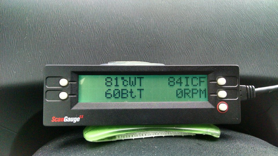

    That is what I got driving for 20 minutes in city. I don't have the codes for scangauge for TB1, TB2, TB3. The only one I have is mentioned as BtT.
