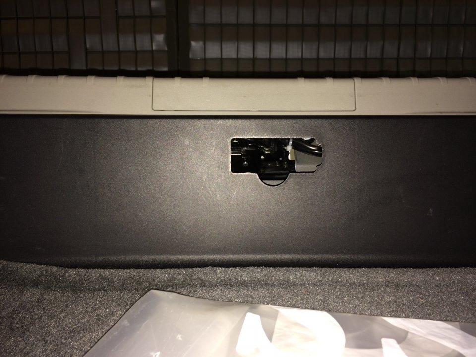

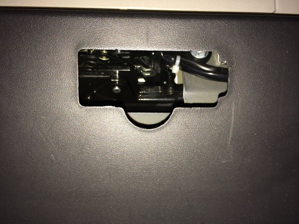

    For future reference...
    The manual hatch release is the L-shaped shiny metal piece in the centre of the image.
    Here's a zoomed out look. This is the cargo area of a 2010 Prius Liftback, looking out towards the rear of the vehicle. The false floor is removed and you're looking at the underfloor bin with the door sill at the top of the image in "light grey". The underfloor bin has a remove plastic door as you can see so that you do not have to remove the entire bin to access the manual release for the hatch should the 12V battery die.
    MPGS-LOL likes this.

    This is the v station wagon forum, I am not sure how similar it will be.
    Tim Jones likes this.
  13. Tideland Prius
    45,429
    16,673
    I understand that but when I read the thread, I was thinking "if someone was to search for trunk release and come across this thread, it won't be useful for them to just "consult the manual" especially if it's a used vehicle they bought and the second hand dealer never bothered to give them a manual because it was lost/misplaced by the previous owner" so I provided a photo reference.
    It'll be similar. Where else would the hatch release be anyway?

  16. bydabayou
    bydabayou New Member
    Feb 27, 2024
    New Orleans
    2015 Prius v wagon
    Actually it is not similar. There is no silver lever in the middle or any other I can find.
    This is not the same as a Prius V.
    #16 bydabayou, Feb 27, 2024
  17. Tideland Prius
    45,429
    16,673
    Ahh ok. Is there a picture you can show us to let others know how to manually release the hatch?
