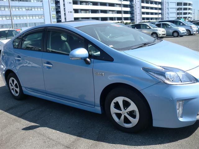

    I certainly hope it isn't black.

    Thankfully, it is Blue. Still a month to go before I receive it. I hope it survives the harsh weather here.

    The color IS very nice, probably the next best color to white. It's interesting, it appears that the Japanese version doesn't have the same wheel trim as the North American version. At some point you'll have to tell us how you will normally use your new PiP, whether for commuting daily or for occasional long trips, etc. No matter what, it will be rewarding.

    Thanks. I opted for this color since Pearl White is very popular in my country and I wanted to have a change from the usual. As for the wheels, it is 15" alloy rim that comes originally with the car. Not sure how the North American version looks like but will check on Toyota U.S.

    That's the same wheel trim as the European model (in fact my car is just like that, same colour!). I'm afraid you'll find that the grey trim is just a cheap and cheerful plastic, although it's an alloy wheel underneath.
