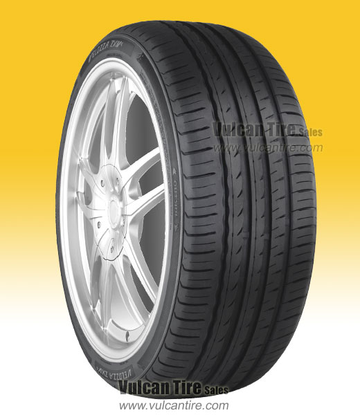

    Good to hear. (y)
    What are the tires again?

    Velozza ZXV4

    The Velozza ZXV4 offers precision-engineered all-season performance at an economical price. This tire delivers maximum all-weather grip, confident high-speed stability and exceptionally crisp handling for those drivers seeking a combination of outstanding performance and superior value.
    Optimized performance design for confident cornering and excellent straight line stability
    Advanced tread compound provides extreme grip and maximum stopping power
    Large angular shoulder blocks enhance precision steering response and handling
    Lateral grooves quickly evacuate water for superior wet weather performance
    Asymmetric tread pattern for reduced irregular wear and a smooth quiet ride
    M & S rated for year-round performance capability

    They were on it when I bought the car and they were just about new. Going to wear them out before I go to a LRR. While they may be inexpensive, and not LRR, they do ride and grip very well. No complaints at all with them. I don't think I'll every buy another set of non LRR tires for anything I drive, but if I was looking for a decent performance tire at a good price I'd buy them.

    If they're not giving you any trouble yeah: wear 'em out!
