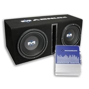

    I compared the II's and III's stereo's extensively before purchasing my II. I don't need bluetooth - others may.
    IMO, for the $230 I have in front speaker and powered subwoofer upgrades, it blows the III's JBL system away and was much cheaper.
    The only drawback is that now I have (2) 10's in a 45lb box in my trunk. I wired in quick disconnects so I can take it out if necessary, but haven't needed to yet. I previously had a powered 8" tube, but it wasn't cutting it, so I went with these MTX subs:

    I'm tempted to add that Magnum subwoofer/amp setup to my JVC KW-NT3HDT aftermarket head unit (with stock midranges/tweeters). It's rated as weighing 50 pounds; not too significant, though I wonder what it would entail costwise in terms of a loss of MPG cumulatively over time.

    I haven't noticed any change in mileage. It's really insignificant. A gallon of gas is ~6lbs - I doubt anybody really notices reduced fuel economy just after they fill up and add ~50lbs to the vehicle? BTW - I average 56MPG (computer calculated albeit) on the some 6k miles I've put on my '10 Prius so far, so I would say I'm pretty sensitive to fuel economy :)
    Also, power draw is insignificant as well. I have these on a 10A fuse and have never blown it even playing at the loudest levels I can take.
    I took a gamble on these MTX subs. Reviews have complained about the amp quality, but heck, ~$150 for decent subs and a nice box is still a good deal even if I have to replace the amp later. So far, no complaints and they totally blow my old 8" bass tube away. They play loud enough for me, low enough, and are very tight and clean.

    yup, I like the idea of using the head unit's internal crossover to spare the midranges and leave all the heavy lifting to the MTX. ;-) That is an amazing price, especially when it includes the amp. I'm sure it's built in China, lol.
