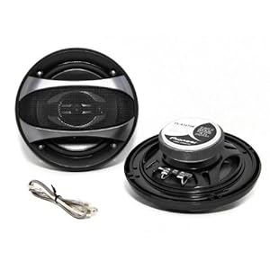

    3-ways? They seem to be 3-way coaxials to me...meaning...you have one channel going to the speaker...the speaker has a woofer, a "midrange," and a tweeter all in one package. There is no dedicated crossover to separate the individual components.
    This is your speaker, right? [​IMG]
    That is a coaxial...a 3-way coaxial.

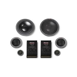

    This is a true 3-way speaker (Dynaudio): [​IMG]
    And because it is a coaxial, the woofer is not made for low bass...and does not get a dedicated amplifier channel to provide enough power to make low bass.

    I believe they're called triaxials, coaxials are generally woofer and tweeter, where 3 ways or triaxials are woofer mid and tweet ... at least that's the way they used to be designated. Maybe they've changed and now they're called 3 way coaxials ... I'll take your word for that if that's the case.
    Either way ... they're 3 ways, and given enough power, they reproduce bass down to I think it's 20 hZ, if I remember correctly ... although I don't really believe that. :D They sound just fine ... very tight bass which is what I like ,,, not boomy at all.
    Correct ... no crossover ...

    Yup, triaxial is a better name...you're right.
