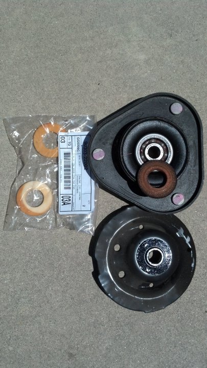

    From the Amazon picture, the complete bolt-on front strut replacement looks complete. The upper insulator looks like a copy of Toyota's upper (rubberish) insulator boot. Hard to tell if there is any lower insulator in this same picture. However, on Unity's website, and a close-up of an unknown front replacement strut assembly (LINK), there appears to be something there.
    Contact Unity in Florida (telephone, email, and web entry form provided), to be certain. I'm sure they would be more than happy to respond, as they are probably eager to gain market share.
    Their website claims:
    "Complete Strut Assemblies include all the components required for strut replacement in a single, fully-assembled unit. They feature pre-assembled replacement bearing plate, upper and lower spring isolators, upper spring seat, coil spring, boot kit, and a premium strut."
    No mention of a dust seal, but that isn't so critical in my opinion. If I recall correctly, the KYB strut mount plate uses a sealed bearing vs open bearing in OEM. This dust seal absorbs the oil/grease from the exposed bearings in the upper bearing plate. It probably helps keep debris from getting into the open bearings as well. When I had changed my front struts, this seal was very oil; see attached picture.
