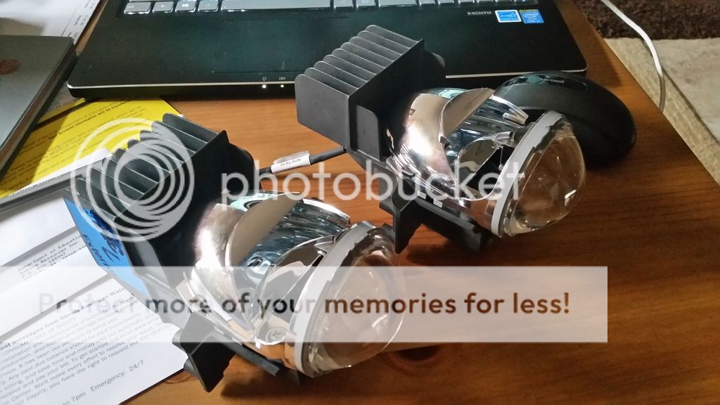

    Yes--I'm doing this right now, in fact. Retrofitting hybrid Corolla/Murano LED projectors into the stock halogen housings.

    Even a three-sided LED is going to have the same issues with light distribution because of the discrete nature of the LEDs versus a filament. And having done the retrofit, I would not hesitate to recommend it to anyone. This was my first attempt at retrofitting a headlight, and it was very doable, with basic tools, and great results.
    My advice, take it or leave it: I tried plug-and-play LED bulbs before deciding to do this retrofit. Simply put, they suck. The distance lighting is horrible, and they put out significantly more light through the squirrel finder than halogens (which will manifest as glare to oncoming drivers). The LED projectors are head and shoulders above in output, color, and cutoff, meet FMVSS regulations, and use significantly less energy to boot. Don't waste your money like I did; do it right, or leave it stock.
