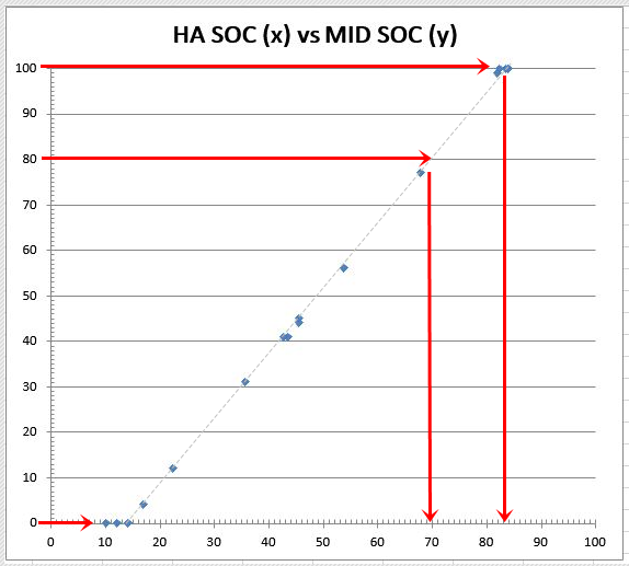

    Data and reasoning presented in my comment #20 which is supported by data from many others indicate that there is no extra 15% reserve buffer below the HV portion of the traction battery as shown in your diagram. And from the Toyota's own published spec, the usable portion of the traction battery for the EV operation should be ~6.3kWh not 5.3kWh as shown on your diagram.

    I don't remember seeing your graphic before. The graphic looks fine except for the bottom 15% reserve and EV portion being smaller than Toyota's spec. Remove the bottom buffer and add that to the EV portion, it will fit the observed data and spec.

    14% according to @Salamander_King, minus the daily self-discharge.
