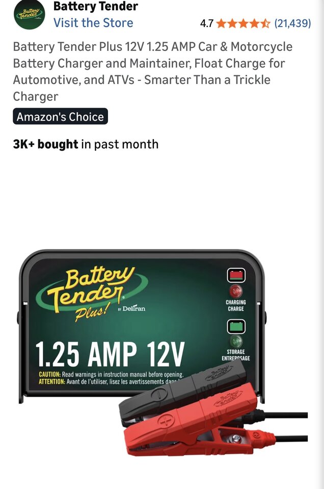

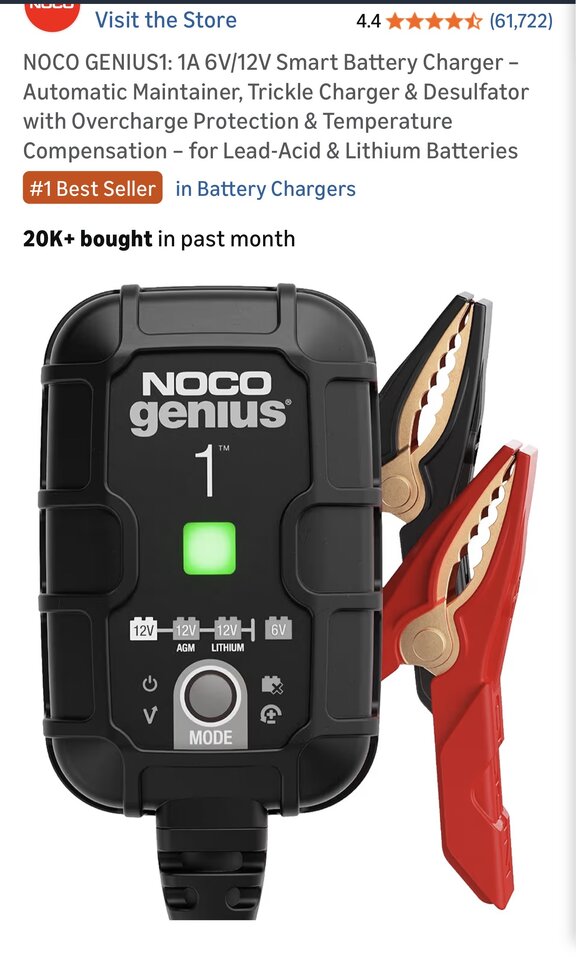

    The best way is with a multistage charger overnight.
    Otherwise drive it for at least 30 minutes but realize a deep discharge takes life off of the battery and 30 minutes should hold it for a day but don't expect a week or more parked without the full charge and cycling a multistage charger provides.
    $29
    $58
    The reality is there will be a day when you drive to a store, park for 20 minutes and it won't start. A jump pack in the car is smart insurance; I have one in each car. Replacing the battery at 6 years is a proactive move as well.
