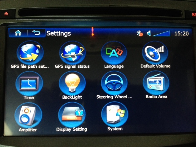

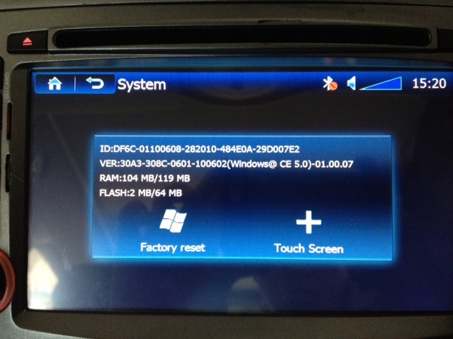

    I can only see it is running wince 5 or ver: 30A3-308C-0601-100602 (01.00.07)
  13. Bulle
    Bulle Member
    Nov 5, 2011
    378

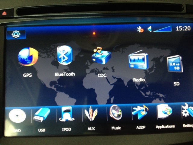

    Then post some pictures of the unit please.

    This doesn't look like a Roadrover unit so I don't think our skin tools will work here.
    On the other hand, you can still probably install more apps by using MioPocket (free).
    Or if you want to be sure, ask Petrut at www.wincepatch.com 's blog.
    He has a nice wrapper package (but $$$) which is a subset of MioPocket.
    At least he will probably support your unit.
