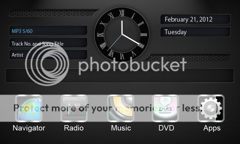

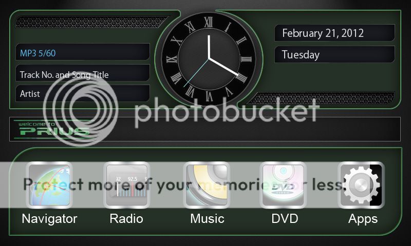

    Bulle sent me a nice little present tonight so I can now compile my own theme.
    Here is Clayfree Metal v001
    http://dl.dropbox.com/u/6709347/Prius/CFM_v001.zip
    It has redesigned : Home, Music, Apps, Music and Radio screens. I will release versions as I redesign more screens.
    You can combine it with one of these wallpapers:
    http://dl.dropbox.com/u/6709347/Prius/Clayfree_wallpapers.zip
    or can make your own homescreen wallpaper from this PSD template:
    http://dl.dropbox.com/u/6709347/Prius/Metal%20Wallpaper%20Template.zip
    :rockon: This is all possible thanks to Bulle :rockon:
    Enjoy and report back how it works!

    Thanks for the home page template Clayfree.
    It's very helpful.

    Very nice jsd!!
  10. clayfree
    clayfree Junior Member
    May 12, 2008
    69
    Frisco, Texas
    Nice work JSD!
