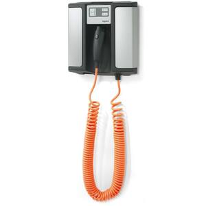

    Nope, I never heard of "Legrand".
    I've been a principal design engineer doing electronic design for well over a dozen years. There are a ton of ways to reduce the cost of a product. Of course, that means some trade-offs.
    So, ... my guess is that the "Legrand" charger cuts cost by:
    1) Lower quailty "charging cord" wire. I'm also not a huge fan of coiled wire. It puts a stress on the strain reliefs on the charger body and the charger's handle.
    2) Designed to operate in temps not much over 100F.
    3) Less margin in the electronic components (run them closer to their max rating). This greatly increases the chance of a component failure. Heat is one of the main reasons why electronic components fail.
    My take: For the PIP, since it doesn't take much charge anyways. So that charger may be fine.

    If your panel can handle the load of a 40A breaker, the best deal currently is the Schnieder electric unit at $799, this unit can handle future EVs with up to 7.2KW on board chargers, both the Legrand and the Leviton are 16A units, which are capable for the current generation of EVs (and PHEVs) that use 3.3KW onboard chargers.. It's similar money for double that capacity, if your panel can handle a 40A breaker.
    FYI, I have the Schnieder Electric EVSE installed.
