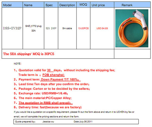

    Here is the "Open EVSE" webpage, this is being done by some members of the MNL (MyNissanLeaf) forum, there are several sources of the J-1772 cables, here are some links:
    Bisco, to answer your question, the OpenEVSE board costs $80 for the GFI model (availble from ChrisHowell who designed it, and is taking orders for them assembled with all components, this is what generates the Pilot signal and controls the relay/reads the current for the GFI via the CT, etc), the other components needed (30A relay, 12V power supply, CT transformer for the GFI) are about $50 from digikey, you also need some gland nuts, a plastic case, some 10/3 type SO cable & a 30A connector), so about $175 + the cost of the J-1772 connector & cable, figure its still going to cost you nearly $300 to put one together, assuming you can get the J-1772 connector & cable for $125.00, You can build one that is only good for 20Amps, but the common J-1772 cable assemblys are comming as 30A, so you might as well just build it to handle 30A, you won't save much building a "less capable" EVSE
    Cost summary:
    $80 open EVSE board
    $51 Digikey parts (30A relay, Current Transformer, 12V PS)
    $10 CG-16 Gland Nut
    $29 L6-30 Plug to L6-30 connector, 6'
    $7 4x4x2 32cu plastic junction box (Home Depot)
    $125 DOSTAR J-1772 30A cable w/20' wire
    $302 Total

    Dostar makes a cable set for $94.89 from China (shipping extra, minimum order qty ~10-20), from this thread: My Nissan Leaf Forum • View topic - ITT J1772 Plug/Cable Set
