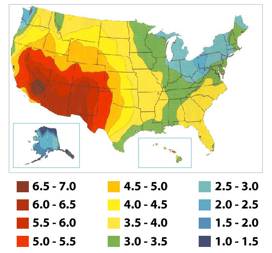

    Yes, it is. New Mexico is one of the best places for solar power.
    Found this image showing the difference:

    My home is located in the 6.0 - 6.5 zone of the map posted by drees, so hopefully the system power output will meet expectations.
